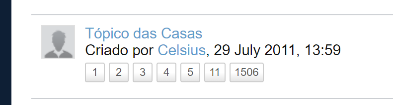

                            #44
                            I just checked and the last page says 1506 which is correct.
                            If the forum display page has loaded and then later someone posted in one of the topics that would cause a new page, the pagination buttons in the forum display page will not be in sync as expected unless you reload the page. The pagination buttons don't get updated in real time, otherwise, it would slow the forum down if you want it auto-updated.​
