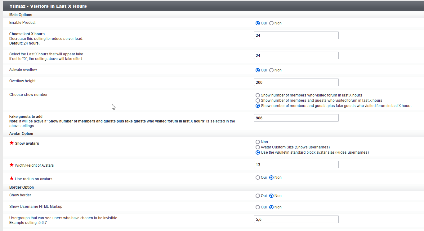

The 1454 guests are the fake guests. It's an option in the settings with the added number of fake guests.
Both mods work fine. I will test the two mods for a while and decide which one to use. Your mod seems to have the advantage of not adding a MySQL table and it's important for me. The difference between the two mods is visually very small in the design as you can see on this screenshot that I will delete in the next few hours.
I take no offense. I was just explaining that the number of guests seemed to be the currently online guests and not necessarily within the 24-hour cutoff. And now you disclosed that it is fake. If the fake guest count is set as an option, then you have to always modify it to make it dynamic and look like real? And I don't know why it adds a table in the DB as the last visitors info already exists in the database. My Last Visitors mod is the same as the "List Visitors in the Last 24 Hours" in the User Manager in AdminCP. The only difference is I made the time cutoff as an option instead of the fixed 24 hours.
So you'd have to keep on updating the fake guest count in order to make it appear real? Otherwise, showing 986 guest count every 24 hours or the count not even changing within 24 hours would make it look unreal as guests (including bots) usually come and go.
No, I set this number just to test the Yilmaz mod. I installed the mod just a few hours ago after seeing a post on vBorg.
My vB 5.6.6 forum is in test, it is not yet online. My vB 3.8.11 is online. When the forum 5.6.6 will be online, the number of fakeguests will be 0 since the content of the forum is almost totally hidden by many graphic placeholders. Why put a number of fake guest other than zero if the content of the forum is not visible to guests? ;-)
