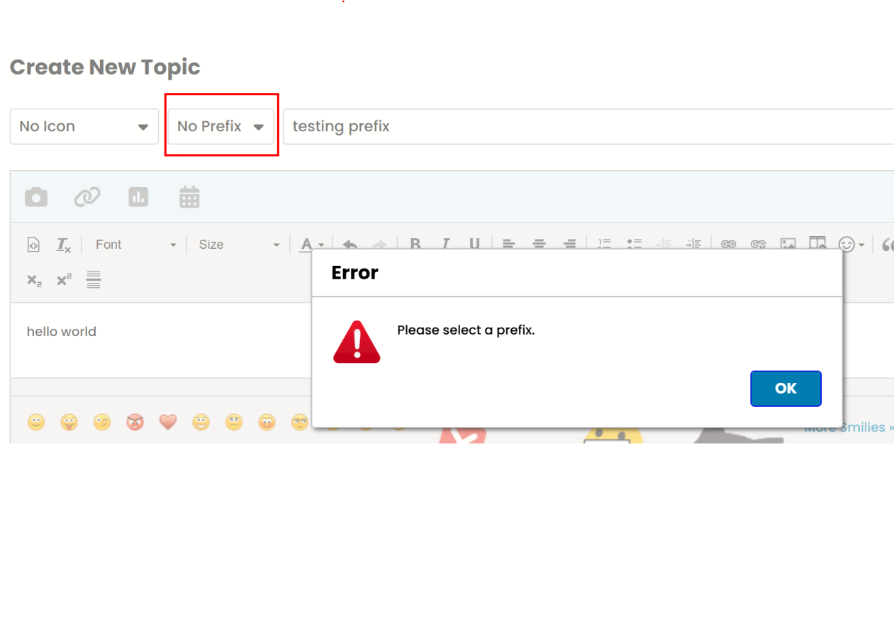

                        flohse, I tested the mod in vB 6.0.8 and it works.
                        1. Did you configure the prefix correctly? You should see the Prefix dropdown next to the Topic icon and title fields if you've set it up correctly.

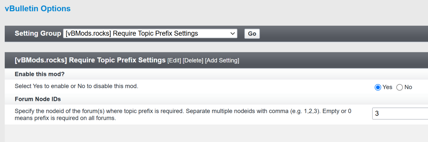

                        2. Did you set the Forum Node IDs option in the Require Topic Prefix Settings in AdminCP?
