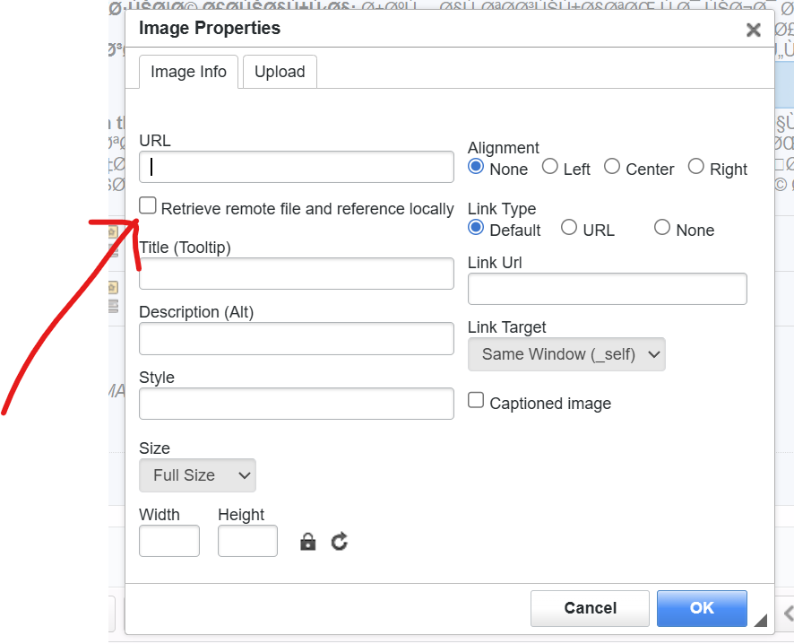

        After logging in to your forum, I tested it and it works on my end. The "Retrieve remote file and reference locally" checkbox is unchecked by default. So it looks like the mod is working as expected.

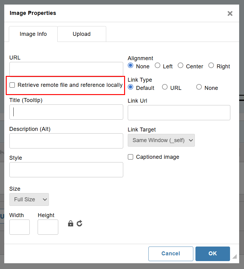

            I tried and tested this mod in vB 6.1.6 and it works for me. When clicking the Image toolbar button in CKEditor, the "Retrieve remote file and reference locally" checkbox is unchecked.
