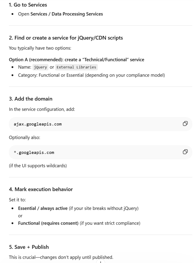

      I asked ChatGPT and it said you must configure it in the Usercentrics Admin Interface as a service / domain rule.

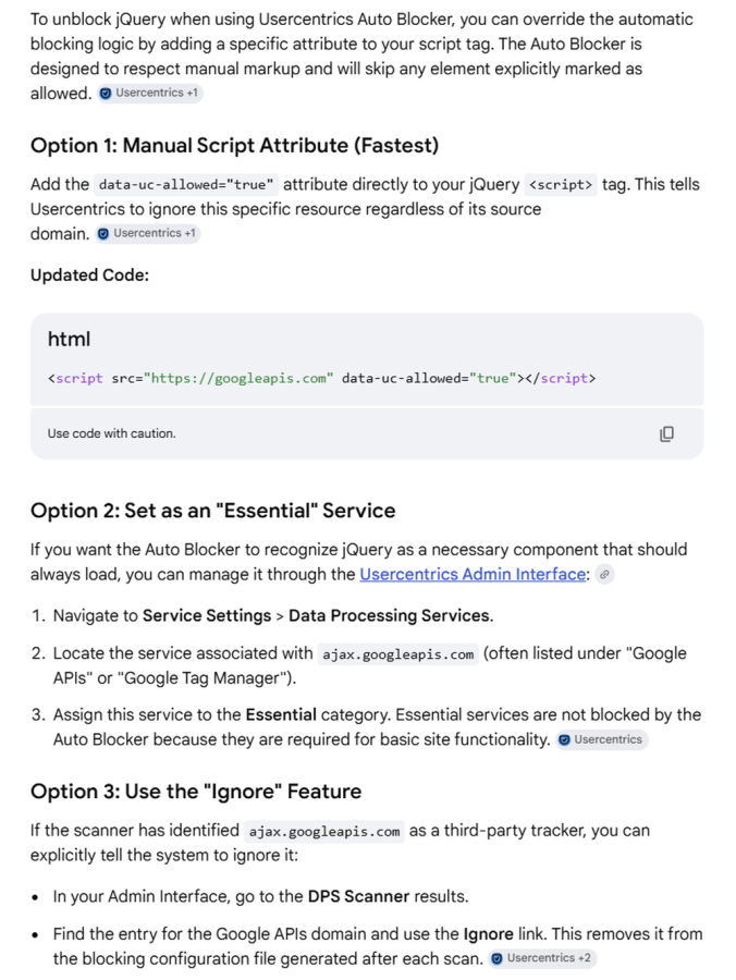

          I tried Gemini and this is its suggestion. Option 1 requires editing existing vBulletin template (the same thing we did to the mod script) which is not recommended. So I prefer to do Option 2 or 3.
