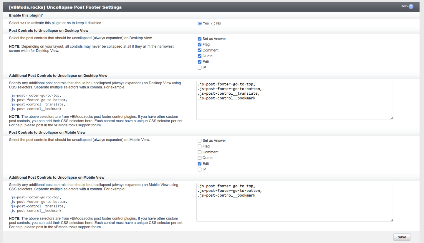

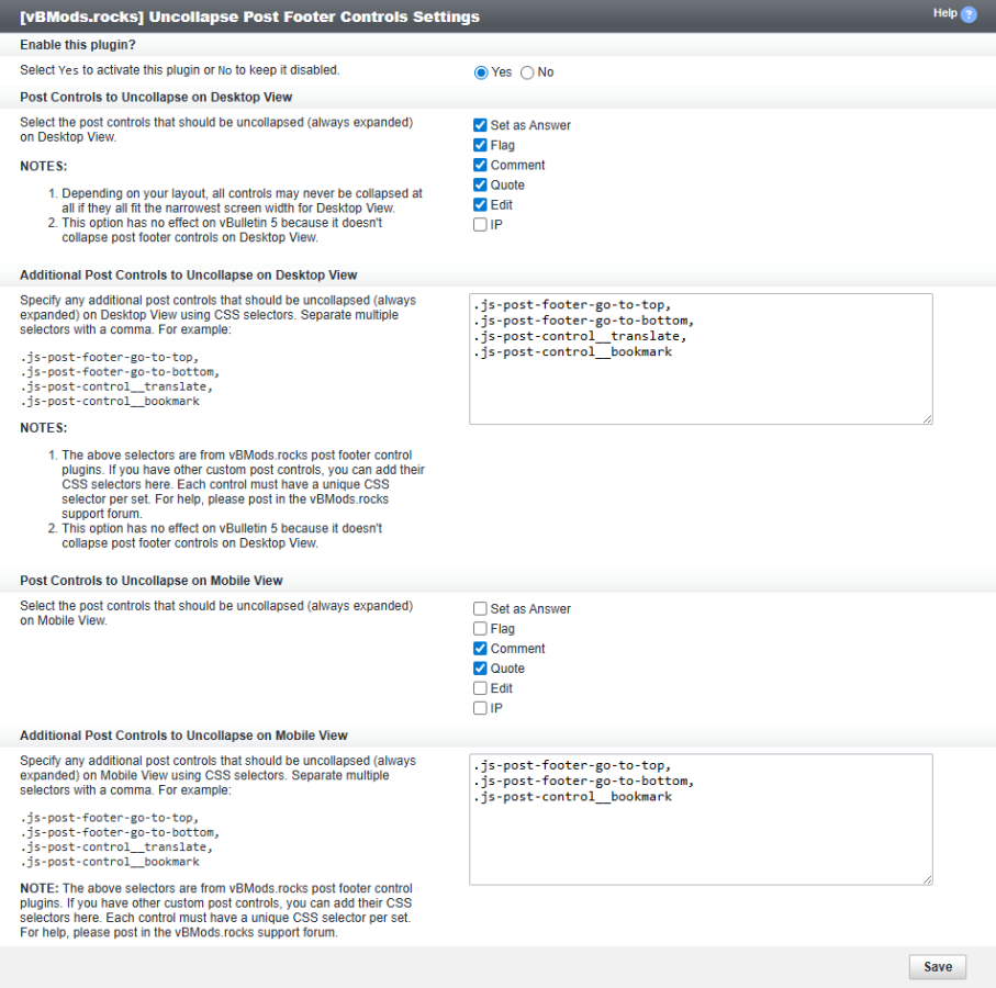

                Unfortunately it does not work for me.
                Mod setting:
                ​But controls are still collapsed.
