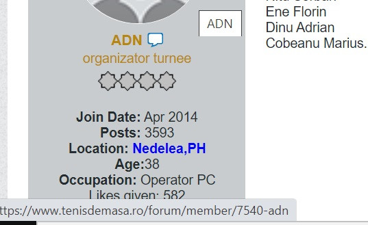

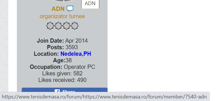

          wrong URL when clicking User in Viewtopic
          Hello, on my vbulletin 5.6.4.1 I have a strange link for user profile in viewtopic :
          Instead of :
          https://www.tenisdemasa.ro/forum/member/7540-adn
          it is
          https://www.tenisdemasa.ro/forum/https://www.tenisdemasa.ro/forum/member/7540-adn
          This is not happening for all user profiles, some are correct.
          For example, in the same topic, for the same user I have two different links for user profile, one incorrect.
          I see the main URL
          of the forum is added once again as a prefix for the real link
ID:	23058Click image for larger version
