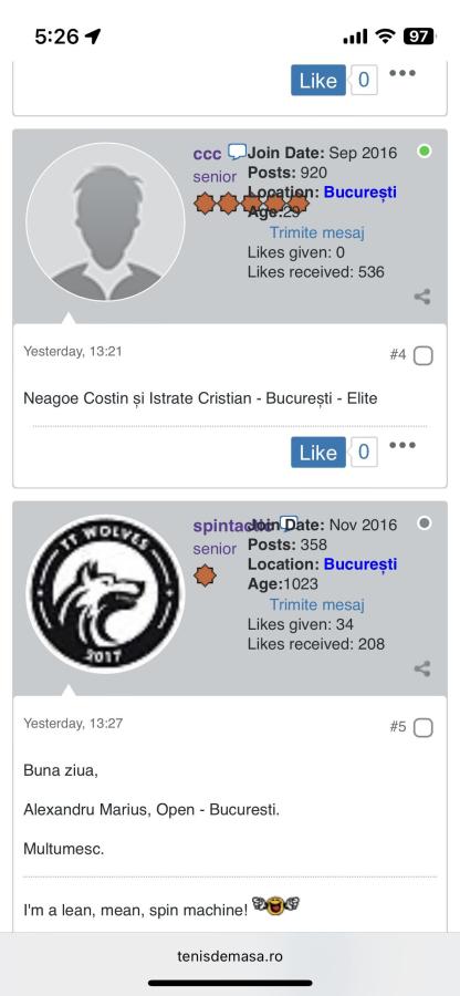

                            I use this mod since few years and I am not sure if this is the cause of my problem.
                            On mobile (phone) the Userinfo overlap the space when the user is logged in. As guest it looks ok:

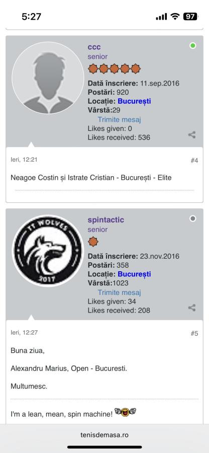

                              And as guest. Click image for larger version
                                I don't think adding the round avatar CSS code will affect the layout. You can confirm this by temporarily removing the CSS. I think there's something else in the CSS is causing the issue. But I can't debug it on your site since you said the issue only occurs when logged in.
