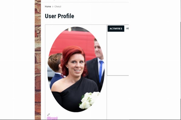

          Thanks for your support. I did rounded avatars but some avatars are more rounded(oval) . I read topic but i couldn't. Can you please help ?
            #95
            If an avatar is not a square, then it will become oval. You don't want to force it to be square as the image will be stretched.

              Had a member join today and his/her avatar came out like this. Is this a product of the avatar being too small? I'm sure force stretching the avi isn't ideal, but is it doable in times like these?

                  I got a bug on some avatars.
                  I'm pretty sure that is from image size.
                  Is there possible to fix this bug?

                    That's not a bug. That happens when an avatar is not square. If you force it to be square using CSS, the avatar will be skewed or stretched and may not look good.
                      Is that possible to fix this out?
                        Yes by forcing the avatar to be square using CSS. But it may not look good as I mentioned in my previous post.
