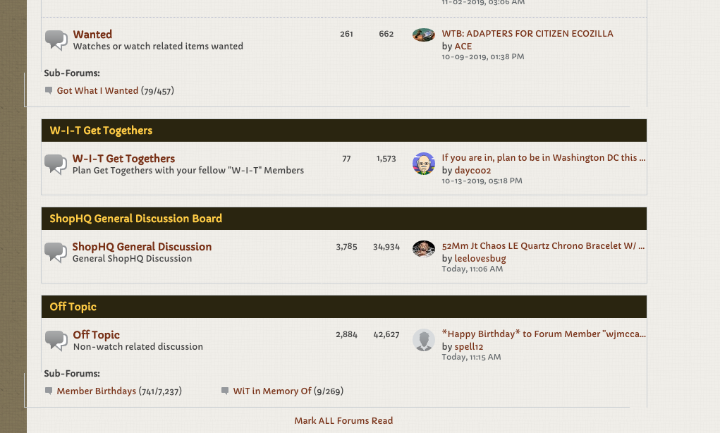

              Something happened when I updated to 5.5.5
              Anywhere I have sub-forums at the bottom of a category the border has shifted to the left. Any idea why this might of happened? It was perfect on version 5.4.5

                #52
                Same issue as stated above with 5.5.6 too.

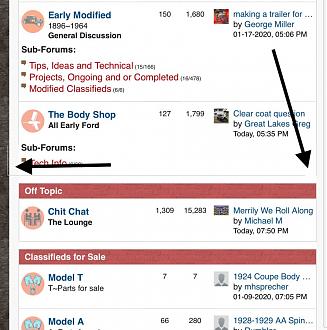

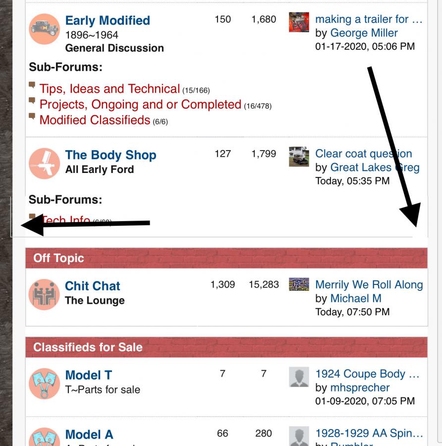

                  I have the same problem.
                  Click image for larger version  Name:	03E29C94-CF6C-4DB2-9EA0-B68F738DCEE9.jpeg Views:	0 Size:	103.9 KB ID:	21170
                    #54
                    This is happening on all devices and views
                          I found the fix. Change the -29px in this line to -6px
                          #forum-tab.forum-category-spacing .subforum-list.forum-item-last > td:after {
                          margin-left: -29px;
                          And change the -29px in this line to -5px in this line and that fixes the alignment
                          #forum-tab.forum-category-spacing .subforum-list.forum-item-last table {
                          border-left: 1px solid #C9CED2;
                          margin: -18px 0 -14px -5px;
