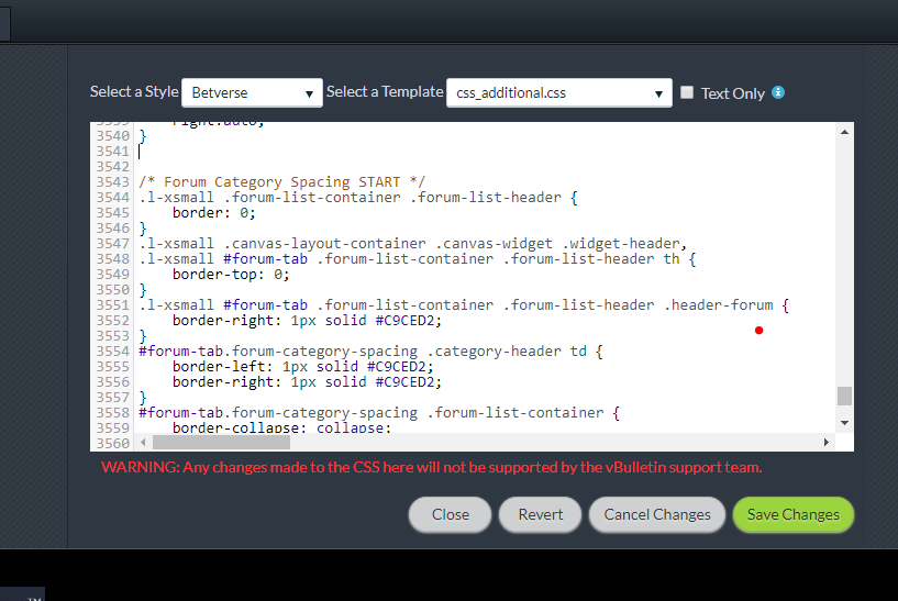

            I have made the changes as in
            https://vbmods.rocks/forum/vbulletin...oud-compatible
            nothing seems to have changed, below is the forum layout we currently have and the image below that is what we are looking for, you can see here
            This is what I am looking for coloured bar including title as below, then forums listed below 1 forum per row not 3 forum per row as in the example I have shown above.
            These are the changes I have currently made

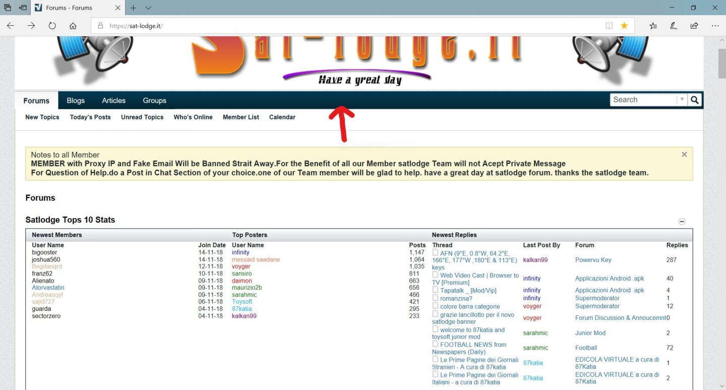

                        how can I change this colour bar
                        thanks for any help
                          header_tabbar_background
                          I did mine using gradient
                        • voyger
                          can you elaborate bit more step by step pleas
                          would like to change the bar colour grey how can I do it
                          thanks

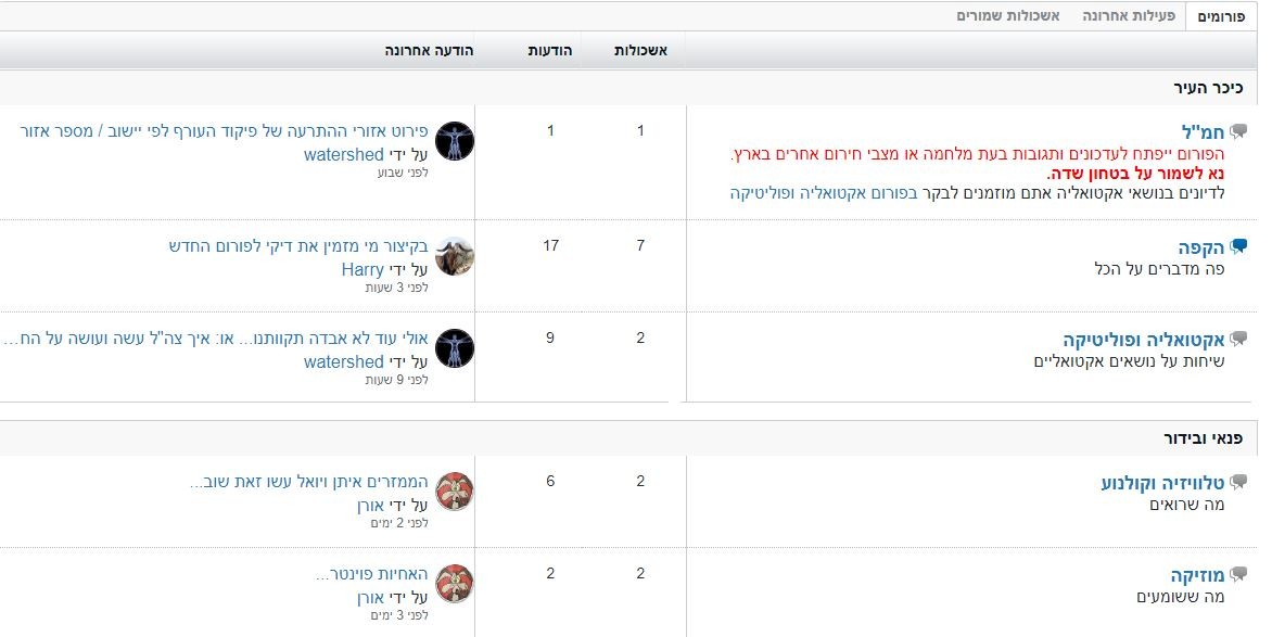

                        Hey glennrocksvb I have tried adding this to my site and I'm getting some display issues with grid lines showing:
                        You can check it out live at https://hakafe.net/ if you change the display to debug_style
                        Many thanks
                          #30
                          watershed, it might be due to RTL. Try replacing all occurrences of right with {vb:stylevar right} and left with {vb:stylevar left}
                          • watershed
                            That is indeed the solution for RTL
