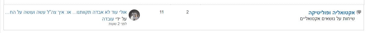

    Hate to be a pain, but my OCD cannot let me overlook a very small misalignment to the left that occurs with the last forum under each category, see here:
    Your CSS solution here is quite long so I'm not really sure where to start
      I cant see it. Can you mark it in the screenshot?

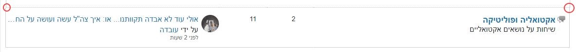

    Click image for larger version  Name:	offsetmark.jpg Views:	1 Size:	19.8 KB ID:	14666
    Here you go, I realize that this is nitpicking the **** out of it

    Change this block:
    #forum-tab.forum-category-spacing .forum-item-last .lastpost:before,
    #forum-tab.forum-category-spacing .subforum-list.forum-item-last > td:before {
        content: '';
        display: block;
        height: -webkit-calc(100% - 16px);
        height: calc(100% - 16px);
        width: 1px;
        position: absolute;
        top: 0;
    [COLOR=#FF0000]{vb:stylevar right}: -1px;[/COLOR]
        background: #C9CED2;
    with:
        content: '';
        display: block;
        width: 1px;
        position: absolute;
        top: 0;
    [COLOR=#0000FF]{vb:stylevar right}: 0;[/COLOR]

      Thanks! That solved the left part of this issue, and I was able to find how to solve the right part:
      Replace
      #forum-tab.forum-category-spacing .forum-item-last .cell-forum:before {
          content: '';
          display: block;
          width: 1px;
          position: absolute;
          top: 0;
      [COLOR=#FF0000]{vb:stylevar left}: 0px;[/COLOR]
      With
      content: '';
      display: block;
      width: 1px;
      position: absolute;
      top: 0;
      [COLOR=#0000FF]{vb:stylevar left}: -1px;[/COLOR]
