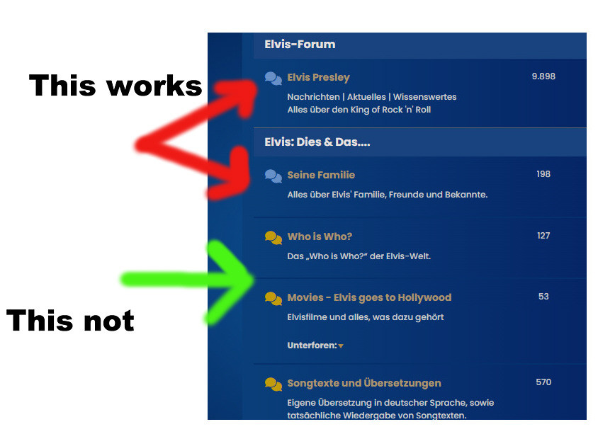

            Thank you for your quick response. Unfortunately, it's not working correctly.
            After double-clicking, the forum is marked as read. But when the page reloads, it's unread again.​
              #25
              Additional info: I have 21 public forums. It works for 5 of them, but not for the others.
              It has nothing to do with user rights or subforums. I don't see any logical reason why this works in some forums and not in others.
              Cache was cleared.
              Example in the attachment
                #26

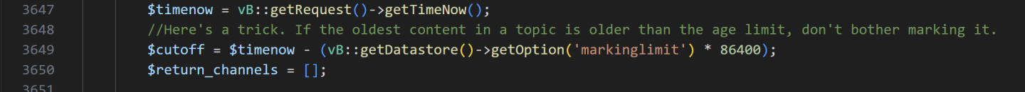

                Mike, please check AdminCP > Settings > Options > General Settings > Database Read Marking Limit. How many days it is set to?
                The system only marks a channel as read if the date of the last content of the channel is within the "Database Read Marking Limit" option. I have a note for that in the first post for vB5 and that also applies to vB6. Please refer to it for more details.

                  It is set to 10 days. Haven't changed it.
                    Is the last post of each affected forum older than 10 days?
                  #28
                  I checked the source code for the Mark Channels Read vBulletin API in vB 6.1.2 and 6.1.3 and it hasn't changed. I also didn't change any logic for marking channels read in the mod. I only fixed the Javascript error due to the missing "simpleversion" variable that was removed in 6.1.3. That variable is just for checking the vB version to make the mod compatible with vB5 and vB6.
                    #29
                    The vBulletin source code even has a code comment indicating to not bother marking a channel read if the oldest content is older than the age limit. Please refer to the green text in the screenshot below:

                    As I mentioned in the first post, I recommend setting the Database Marking Limit to a higher value (6 months to 1 year) as a workaround.
