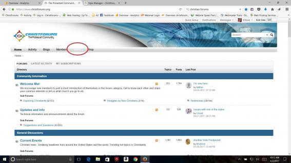

                  An other small usability detail:
                  When inspecting the menu, the arrow pointing down is in an other area then the forum link.
                  When I point my mouse cursor between the FORUMS link and the ARROW DOWN. the dropdown menu disappears.
                  This is annoying because sometimes when you want to select a link from a menu and move your cursor in a specific way the dropdown will not appear.
                  Would it not be better if the arrow was a background image inside the <li> element? Or is there a better wat to improve this?
                    Will look into it. Thanks for reporting.

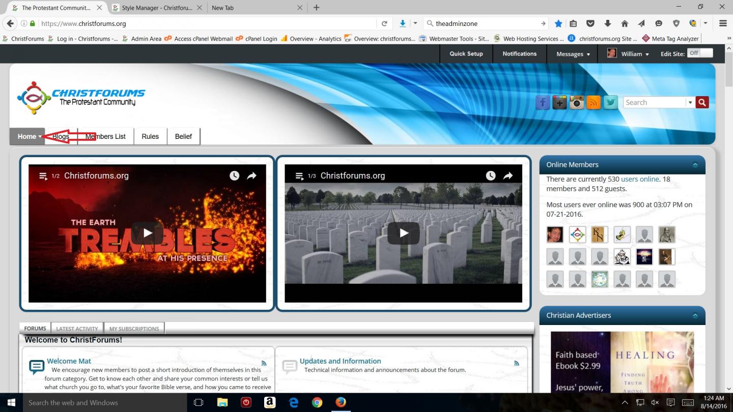

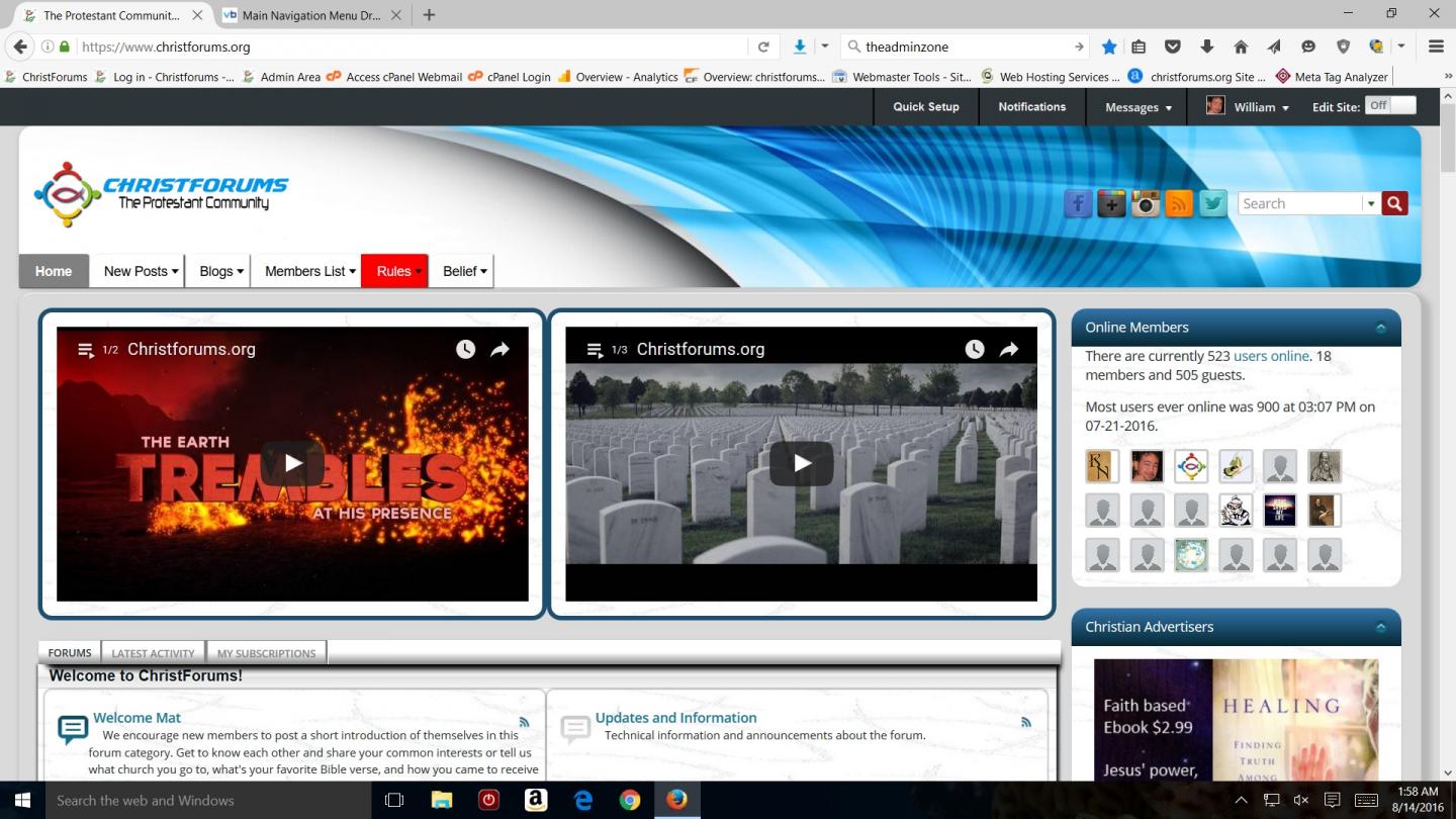

                  Hi Glenn,
                  I can't figure this css out. When I mouse over a menu item and then drag the pointer upwards the text remains white after leaving it.
                  I see
                  #channel-tabbar ul li.selected:not(.current) > a {
                  color: #FFFFFF !important;
                  But if I change it in additional_css the effects do not happen.
                  Click image for larger version  Name:	point off.jpg Views:	1 Size:	28.6 KB ID:	3749
                  Situs slot pulsa indosat memberikan terobosan terbaru untuk memainkan slot via pulsa indosat dimanapun penggemar slot indosat berada.
                    I'll take​ a look when I get home.
                      No rush. I'm trying to make the background white to match the rest of the navbar. However, the text needs be black and remain black when the menu option is either selected or not selected.
                      Thanks Glenn,
                      William
                        I see a different default theme on your site which looks like the vB5 Default Style. I don't see the style in the screenshot you posted
                        Anyway, the trick to debug the CSS for this particular mod is to add "selected" class in the <li> element with "section-item" class and then setting "display: block" in the submenu dropdown <ul> (with class "custom-subnav-dropdown") inside the section-item element. When you do this, the submenu dropdown will be kept opened and you can inspect the elements without the dropdown being hidden to customize the style.
