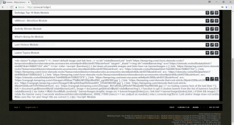

          silly me done a bodge up need help pleas likely done on my test forum
          what i done did cope the code on first post and paste on html static module now can't let me edit or removed
          glen can you help pleas
            You can't click the Pencil icon?
              i can
              click to the Pencil icon but nothing append is like is lock it i haven/t the option to edit o removed
                It looks like you pasted the script in the module title field and not in the module HTML field.
                  yes i did was my mistake pasted in the wrong place is any way how can remove or edit?
                  thanks sorry for the trouble
                    Try this. Right-click on the code in the title, then choose Inspect or Inspect element (depending on the browser you use). Then in the highlighted source code, edit the the element (right-click and choose Edit as HTML). Then delete the code in the title. Then try clicking the Pencil icon again.
                      hi glen thanks done it solved you are a live saver thankyou thankyou
                      done as you said above worked thank god for that very happy man today
                      regard
