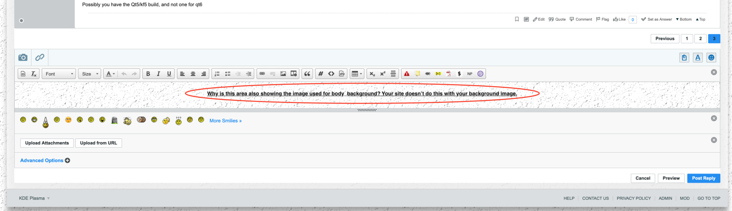

            Click image for larger version  Name:	Screen Shot 2024-03-01 at 11.13.27 PM.png Views:	0 Size:	183.5 KB ID:	29116 Thank you. That works except that the image is also showing in the Post Reply window.
            Well, I guess your site does show your background image in that window, but the opacity (?) is such that it is very hard to notice?
              I don't know why setting body_background stylevar also changes the CKEditor background in your forum when it is controlled by form_field_background stylevar.

                  You have this code in css_additional.css template which is used on both the main site body tag as well as the CKEditor iframe body tag.
                  body {
                      background: url("core/images/misc/5025.png") repeat center fixed;
                  That's why your CSS applies to the <body> tag of both the main page and the editor.
                  I thought you were just updating the body_background stylevar? Why do you have custom code in css_additional? If you just updated the body_background stylevar in the Style Variables Editor, then it would only affect the background of the main page as the CKEditor body background is controlled by a different stylevar called form_field_background.

                        One of the results was this: Changing the Background Also Changes the Editor's Background (?) posted in 2019 on vBulletin Forums. Your reply (post #5) cited the cause and solution, which you posted in this thread here, in vbmods.rocks, in 2018.
                        I rewrote my css_additional.css entry (after setting Style Variable body_background in KDE Plasma back to its defaults) as follows:
                        body:not([class*="cke_"]):not([contenteditable]) {
                        #content {
                            background-color: rgba(255,255,255,0.8); /* white with 80% transparency (adjust as needed) */
                        The image fills the background, is static, and CKEditor isn't affected.
                        Gotta love Google. Really love vbmods.rocks!
                          Glad you got it working. But if the only problem with using body_background was the background image not "fixed", then you just need to add this in css_additional.
                          body {
                               background-attachment: fixed;
                          The body_background should have included background-attachment but since it doesn't, then you need to add the above code in css_additional. It will apply on both the body tag of the main page and the CKEditor body but since the CKEditor does not have a background image, it will not have any effect in the editor which is good.
