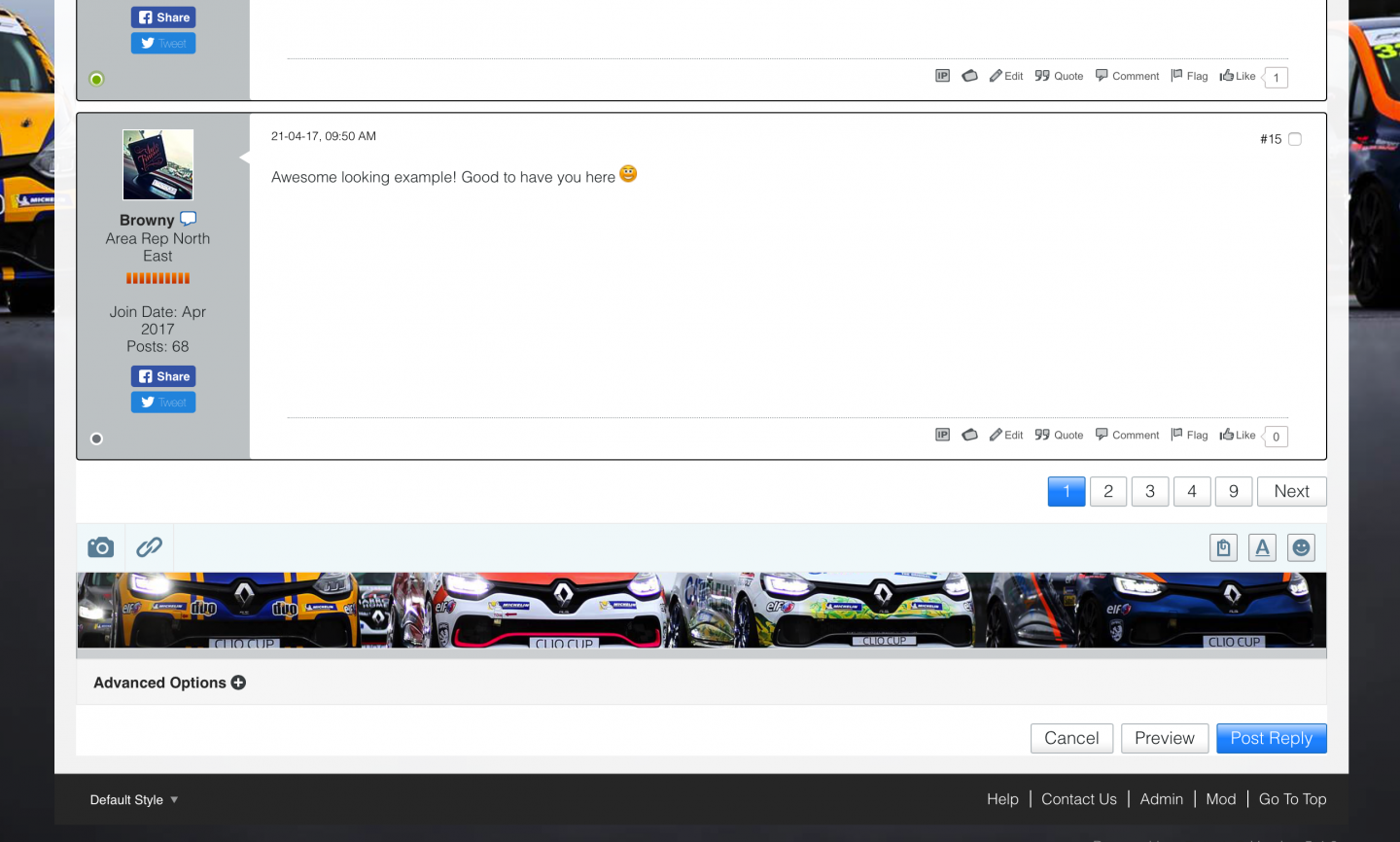

    There must have been an upgrade tonight to my cloud forum and now I have an issue. The reply box for all the treads and pas has an image in it ! it's the one i use for my background. How do I remove it ?
    Click image for larger version  Name:	Screen Shot 2018-06-04 at 19.04.21.png Views:	1 Size:	774.2 KB ID:	11265

    The ckeditor iframe now seems to have css_additional template included in the latest vB5 version. This means if you have custom CSS added for "body" tag selector for the main page, then it will also apply to the ckeditor iframe body. I think that's what's happening to your forum.
      The solution is to change your custom CSS:
      body {
      with:
      body:not(.cke_editable) {
        This solution is now replaced by a better solution I posted in post #9.
        Latest code is in post #16.
        Latest solution posted in post #18

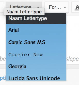

            Is there any way to remove the background in the font type and size as well?
Name:	Screenshot 2018-09-01 14.55.01.png

              I checked and CKEditor iframes tend to have "cke_xxxx" classes in the body tag. So try this:
              Replace this in your css_additional template:
              body {
              with:
              body:not([class*="cke_"]) {
              This means to select the body tag without "cke_" in the class attribute.
              This replaces my suggestion in post #3.

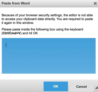

                If you want to paste something as plain text or from Word, the background in the popup now also has a background. What CSS can I use to remove this?
                  Can you post a screenshot Fleiding?
Name:	Screenshot 2018-10-26 19.31.07.png
