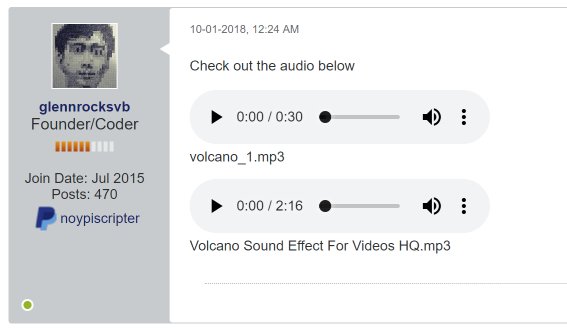

    This is a vB5 mod that transforms existing audio file attachments into an HTML5 Audio player. Click image for larger version Name: image.png Views: 1 Size: 47.3

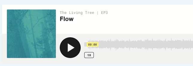

                      They have this great feature on SimpleCast called "Recast" where you can take a 30 second snippet of any podcast and share that separately. They provide a different embed code for the snippet. Here's the embed code for a random 30 seconds of the previous clip that I posted:
                      <iframe src="https://player.simplecast.com/recast/32f59762-31ce-52b9-b34e-dc950277d580" height="600" width="600" title="Flow" frameborder="0" scrolling="no"></iframe>
                      How would I embed that in a post? Do I have to create a different BB code or can I use the pre-existing SimpleCast code? I see they have it saved to a different directory (they save the snippet to a recast directory
                      (https://player.simplecast.com/recast/32f59762-31ce-52b9-b34e-dc950277d580)

                        Since Recast has a different URL structure, you should create a separate BBCode tag for it. The Replacement code should have the iframe src pointing to the /recast URL path like this:
                        <iframe src="https://player.simplecast.com/recast/{param}" height="600" width="600" frameborder="0" scrolling="no"></iframe>
                          Yup, that's it! Wow.
