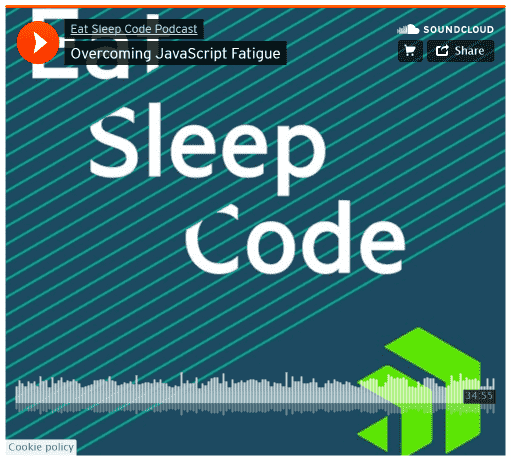

    and it would render like this:
    Click image for larger version  Name:	soundcloud.png Views:	1 Size:	30.3 KB ID:	5141

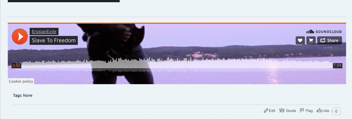

          I installed it on my brand new forum and it shows up in the signature of my sample post. I changed the height to 166 instead of 300, but either way, the picture gets cut off, as such:

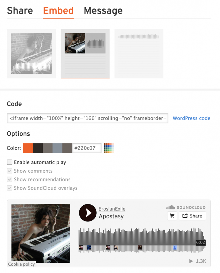

          Is it possible to make the smaller view show up - the one I selected in the middle here? This way the avatar of the soundcloud song wouldn't get cut off if it isn't full size.

            Selecting that one in the middle should automatically adjust/update the embed code. You don't have to change anything in the code. What you did was you selected the first one and then changed the height in the code.
            My Amazon Affiliate Link ​
              I see! It worked! Thank you . Donation heading your way. I am broke but I really appreciate all you've done here.
