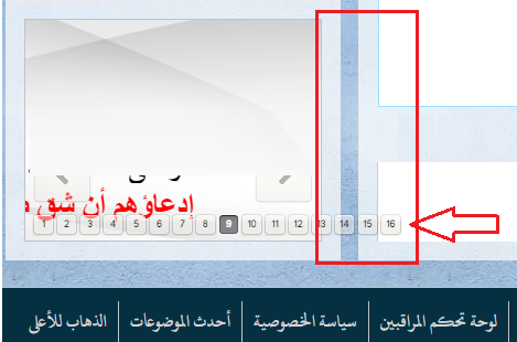

    Hello,
    How could I prevent content from getting out of the box as in the discriminated topics as shown in picture:
    Thank You​
    I have to see the actual page to inspect the HTML and CSS and be able to suggest a solution.
      It is in the main home page, In the most bottom on the left

        Add this custom CSS in css_additional template.
        .b-content-slider__bullets {
            max-width: calc(100% - 12px);
            overflow: auto;
        Note that this code will cause the pagination buttons that don't fit the width to be invisible.
          You may want to widen the sidebar column to accommodate more content.
          In the 70-30 layout, the second column has 300px width (including the left padding of 15px) by default. So the actual width of widget that can fit there is only
          For RTL languages, change margin-right to margin-left. Or better if you are on self-hosted vB6, change margin-right to margin-{vb:stylevar right}
