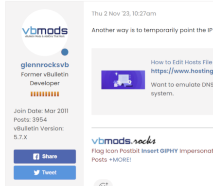

    The online icon appears at the bottom of postbit. In a long post, this icon is not visible that you have to scroll down to see if the user is online or not. This icon should be positioned closer to the avatar.
    Click image for larger version  Name:	image.png Views:	0 Size:	66.9 KB ID:	28478
    To move the online icon under the avatar as shown in the above screenshot, put this custom CSS in css_additional.css template:

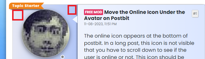

    Once I set it to the correct spot, it changes depending on the users profile picture size and so forth. In other words it is not in the same spot for all users. Ends up blocking info and things
      Unfortunately, it's not going to work for avatars with different sizes. The position is not relative to the avatar but to the container column.
        It would require a JavaScript solution to calculate the position based on the size of the avatar.
          I think for different sizes, Corners will be the best place
