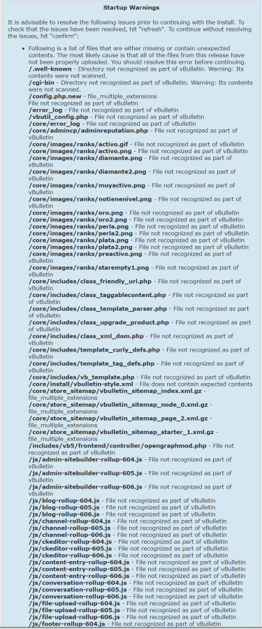

    I'm trying to upgrade vbulletin to 6.0.7
    but I got this whole list of fixes that appears in the pictures
    How can I fix all of this to upgrade?​

    As the software manufacturer is not able to make a script that you can run automatically (with the identification, thats there own old files), you need to remove all (what is really from vbulletin) from the server manually.

        Did you read my post or the info that vbulletin upgrade routine gave you?
        The most are old files, that vbulletin dont need anymore (because of changing of something and/or new file versions).
        ​​​​​​​You can ignore that too (not recommended) and just click on "confirm".
          The problem is, when I press the confirm button, it does nothing until I fix those problems.
            What forumreg said is correct. Did you mean when you click the Confirm button it literally does nothing and does not redirect to the next page? Is there no error message displayed on the page? Check for possible errors in the Javascript console (F12 > Console tab)
