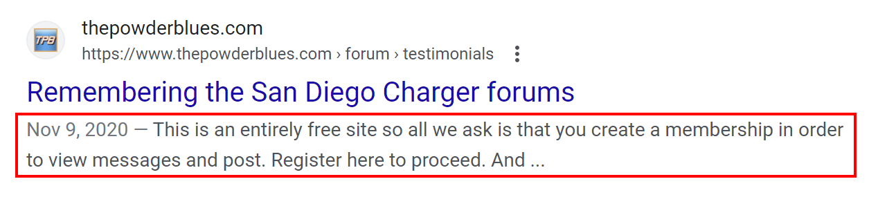

    A Google search results snippet is the description or summary part of search result on Google Search.
    Click image for larger version  Name:	image.png Views:	0 Size:	55.8 KB ID:	28863​​
    Snippets are designed to emphasize and preview the page content that best relates to a user's specific search. So it is vital that your pages would create good snippets to increase click through rate.
    Snippets are primarily created from the page content itself. But for many vBulletin forums the snippet used by Google may show the default guest notice (which is unrelated to the page main content) instead of the meta description of the page or some other related textual content

    This may be because the Notice is at the top of the page content and Google thinks this is the best description of the page.
    To tell Google not to use the Notice as a search results snippet, you need to edit the notice in AdminCP > Notices > Notices Manager and wrap the message inside a <div> tag with data-nosnippet HTML attribute. This change applies to any vBulletin version.
