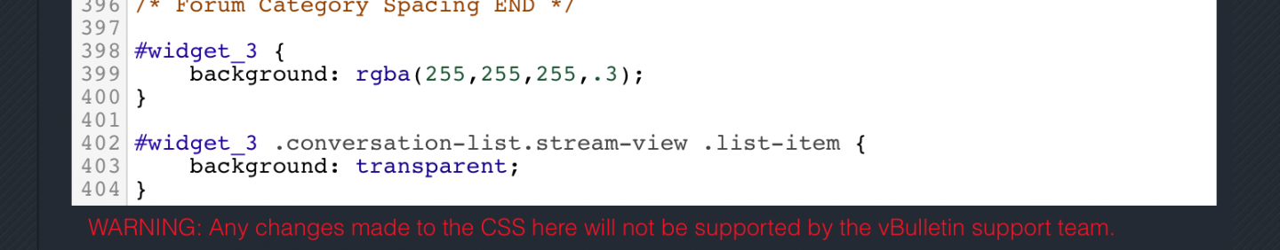

      Still not working Glenn, thanks for your help though
Name:	Screen Shot 2018-07-27 at 08.24.59.png

        I did notice after the upgrade there was additional CSS in where my CSS was, don't know what they have done.
          #34
          I checked your site and it's working. You just set the transparency to .8 which is not that noticeable. Try .5 or something lower.

                    Ah I see, no its the main forum modules I am looking at. As you can see above.
                      #40
                      We are looking at different tab. See my post #37.
                      To make the Forums tab transparent, you have to add the code in red:
                      #widget_3 .conversation-list.stream-view .list-item[COLOR=#FF0000][B][SIZE=16px], [/SIZE][/B][B]#widget_3 .forum-list-container .forum-item[/B][/COLOR] {
                          background: transparent;
                        #41
                        Thanks Glen. I really appreciate your help. now the sub forums are not transparent

                              #widget_3 .conversation-list.stream-view .list-item,
                              #widget_3 .forum-list-container .forum-item[B][COLOR=#FF0000][SIZE=18px],[/SIZE]
                              #widget_3 .forum-list-container .subforum-list[/COLOR][/B] {
                              I broke it in multiple lines as it's too long.
