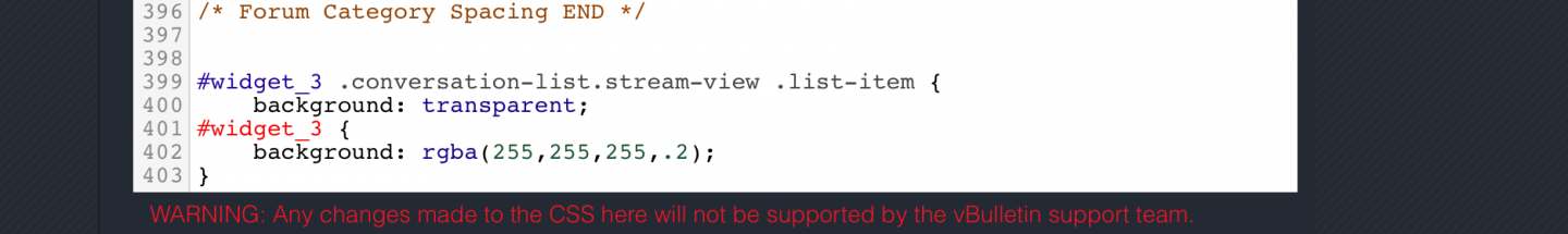

                      You have a stray } right before the CSS code for #widget_3. Remove that, then add this:
                      #widget_3 .conversation-list.stream-view .list-item {
                          background: transparent;
                      Keep the #widget_3 code.
                        #30
                        Like this ?
Name:	Screen Shot 2018-07-27 at 08.17.35.png
