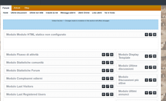

        Click image for larger version  Name:	Immagine 2024-02-05 095421.png Views:	4 Size:	55.0 KB ID:	28868Click image for larger version  Name:	Immagine 2024-02-05 095833.png Views:	0 Size:	199.8 KB ID:	28869Click image for larger version  Name:	Immagine 2024-02-05 095804.png Views:	0 Size:	287.7 KB ID:	28870
        i followed the mitch instructions but is not working..
          i dont know why my last post is red...
            i inserted a display module in homepage

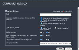

            then inserted the code of glenn at the bottom (model name)
            but in my homepage ( when logged out) nothing appears..
              desmomax if you are using the Display Template module, you only need to specify the name of the template to display. No iframe or HTML code needed. In this case, you just have to specify login_main template.

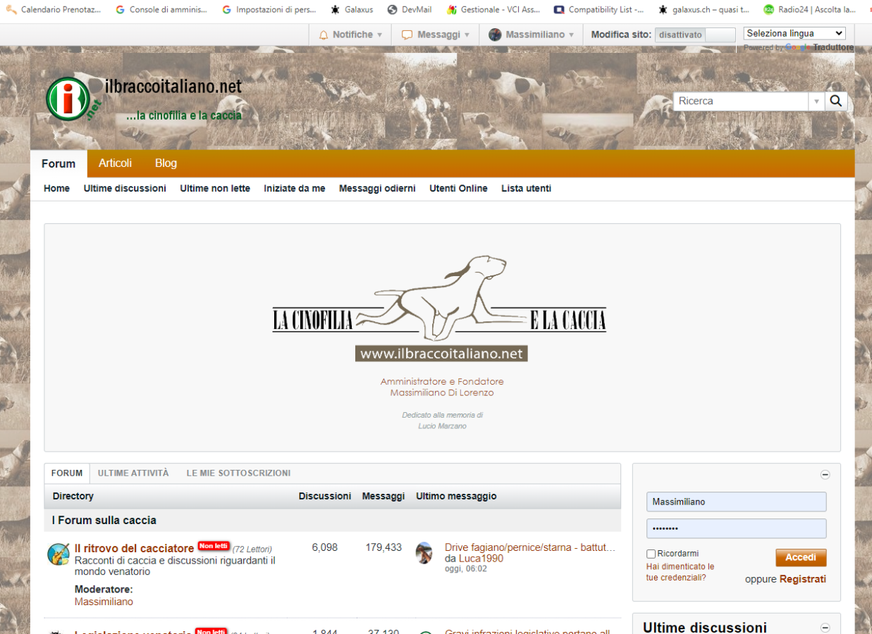

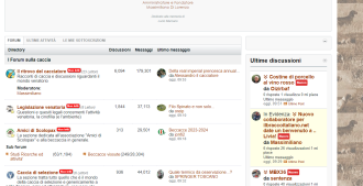

                  i am logged in but the frame still ask me for login and password...
                  I thought once I entered the frame it would disappear...
                  Click image for larger version  Name:	Immagine 2024-02-13 092153.png Views:	0 Size:	617.5 KB ID:	28899
                    Did you set the module permission to show the module to Guests usergroup only?
