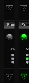

      This is an upgrade which replaces the above code.
      It allows for the use of 2 replacement icons, one for read topics, one for unread topics, whereas the previous code was always set to unread.
      Thanks goes out to Glen for helping me overcome the issues that were plaguing me on this. The solution was so simple.
      You will need to set 2 sets of values for the Forum ID you want affected, the image location and the replacement icons. By default this is 32x32. One unread, one read(greyed out).
      /* Start custom forum icons v2 */
      #[COLOR=#008000][B]forum16[/B][/COLOR].forum-item .cell-forum .icon {
          background: transparent url("[COLOR=#0000FF][B]/images/CustomIcons[/B][/COLOR]/[COLOR=#800080][B]BOS32.png[/B][/COLOR]") no-repeat;
      #[COLOR=#008000][B]forum16[/B][/COLOR].forum-item.new .cell-forum .icon {
          background: transparent url("[COLOR=#0000FF][B]/images/CustomIcons[/B][/COLOR]/[COLOR=#800080][B]BOS32-new.png[/B][/COLOR]") no-repeat;
      /* End custom forum icons v2 */
      In this example, you can see how the forum default icons, triangles, remain the same except on the targeted forum, which becomes a circle.
      If all topics have been read, the icon is grey, but if new topics exist, the icons turn green.

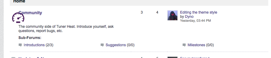

        I attempted to get this to work and had some issues.
Name:	Screen Shot 2016-10-18 at 2.44.25 PM.png
        Notice how it overlays over the section.
        Also, is it possible to enable this for ALL categories, rather than editing the code per category?
        I included height and width and that's how it cause it to overlay. If I didn't have those codes, it would be the default forum icon size.
        Thanks!

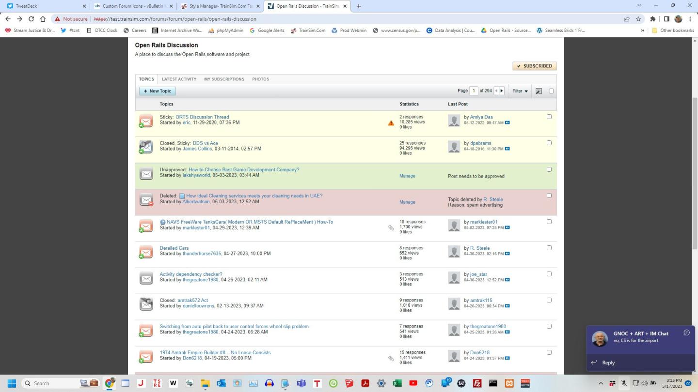

                    If this needs to be its own thread, let me know....
                    Tried the additional CSS and it's working only halfway with 5.7.4
                    For topics I've replied to, the icons show up fine. If I use the interactive close/open the icons change, but the plain vanilla ".read" and ".hot-read" aren't rendering.
                    .forum-list-container .forum-item .cell-forum .icon {
                    background: transparent url("https://test.trainsim.com/forums/core/images/legacy/forum_old-48.png") no-repeat; /* forum icon for forums with old posts */
                    width: 48px; /* icon width */
                    height: 48px; /* icon height */
                    .forum-list-container .forum-item.new .cell-forum .icon {
                    background: transparent url("https://test.trainsim.com/forums/core/images/legacy/forum_new-48.png") no-repeat; /* forum icon for forums with new posts */
                    .forum-list-container .forum-item .cell-forum > .forum-wrapper > .forum-info {
                    padding-{vb:stylevar left}: 1px; /* icon width + 8 */
                    .forum-list-container .forum-item .cell-forum .forum-desc {
                    margin-{vb:stylevar left}: 1x; /* icon width + 8 */
                    margin-top: 2px; /* 17 - icon height */
                    /* Sub Forums */
                    .forum-list-container .subforum-list > td {
                    padding-{vb:stylevar left}: 2px; /* icon width + 13 */
                    /* Responsive */
                    @media only screen and (max-width: 768px)  {
                    margin-{vb:stylevar left}: 3px; /* icon width + 8 */
                    padding-{vb:stylevar left}: 3px; /* icon width + 33 */
                    .vb-icon-topic-status {
                        background-color: transparent;
                        background-repeat: no-repeat;
                        height: 48px; /* this is the height of default icons, remove it if the same */
                        width: 48px /* this is the width of default icons, remove it if the same */
                    /* for hot unread topic */
                    .hot-unread .vb-icon-topic-status {
                        background-image: url('https://test.trainsim.com/forums/core/images/legacy/thread_hot_new-30.png');
                    /* for hot read topic */
                    .hot-read .vb-icon-topic-status {
                        background-image: url('https://test.trainsim.com/forums/core/images/legacy/thread_hot-30.png');
                    /* for read topic */
                    .read .vb-icon-topic-status {
                        background-image: url('https://test.trainsim.com/forums/core/images/legacy/thread_old-30.png');
                    /* for closed topic */
                    .closed .vb-icon-topic-status {
                        background-image: url('https://test.trainsim.com/forums/core/images/legacy/thread_lock-30.png');
                    /* for deleted topic */
                    .deleted .vb-icon-topic-status {
                        background-image: url('https://test.trainsim.com/forums/core/images/legacy/thread_deleted_30.png');
                    /* for deleted read topic */
                    .deleted.read .vb-icon-topic-status {
                    /* for unread topic where current user has posted to */
                    .posted .vb-icon-topic-status {
                        background-image: url('https://test.trainsim.com/forums/core/images/legacy/thread_dot_hot_new-30-left.png');
                    /* for read topic where current user has posted to */
                    .posted.read .vb-icon-topic-status {
                        background-image: url('https://test.trainsim.com/forums/core/images/legacy/thread_dot_hot-30-left.png');
                    /* for closed topic where current user has posted to */
                    .posted.closed .vb-icon-topic-status {
                        background-image: url('https://test.trainsim.com/forums/core/images/legacy/thread_dot_lock_new-30-left.png');
                    /* for deleted topic where current user has posted to */
                    .posted.deleted .vb-icon-topic-status {
                        background-image: url('https://test.trainsim.com/forums/core/images/legacy/thread_deleted_30-left.png');
                    Did something else perhaps change with 5.7.x from when this was originally written?
                    Other than the missing icons for those statuses, everything else works great!

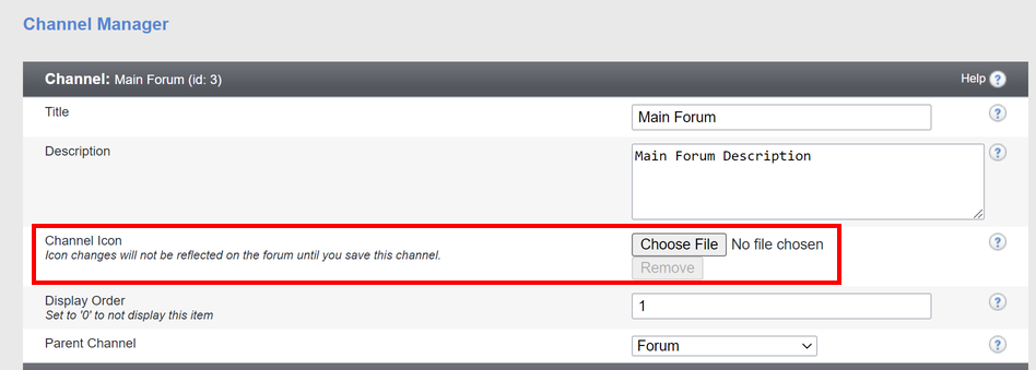

                      Adding custom forum channel icons has been added natively to the forum for a while now. You no longer need to add custom CSS to do that. You simply go to Channel Manager in AdminCP and edit each channel and upload the corresponding image.

                        Good to know, but what I'm trying to get to work are the thread status icons, not the channels.
                        Seems odd that some of it works and some doesn't. I don't see an option for that natively unless I want to try SVG editing...
                          I have to see the site to inspect the page and check the CSS. I suspect the CSS is being overridden by another more specific CSS.
                            ​Yeah, unfortunately I took your advice and am now running it on a laptop with xampp instead of a cloud server..
                            Doing some digging this morning, I found a commented out note in one of the display_topic templates that says it was a known issue that the API wasn't setting the status for .read and four other statuses, and that was being done in the javascript.
                            In the meantime, I found the vb-icon-topic-status buried in css_utilities and replaced the sprite coordinates call with an absolute image path, and that did the trick.
                            <vb:comment>/* End of HEAVILY modified by EFO */</vb:comment>​
