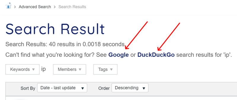

    Click image for larger version  Name:	search-results.png Views:	0 Size:	65.0 KB ID:	24098
    Before giving you the code to accomplish what is shown in the above screenshot, let me give you first the limitations/disadvantages of doing this modification:

      For example, on this site, I added Google and DuckDuckGo. Here's the code I used:
      <vb:if condition="!empty($searchJSONStructure['keywords'])">
      	<p class="alternative-search-engine-search h-margin-top-l">
      	Can't find what you're looking for? See <a href="https://www.google.com/search?q={vb:urlencode {vb:raw searchJSONStructure.keywords}}+site%3A{vb:urlencode {vb:raw baseurl}}" target="_blank"><strong>Google</strong></a> or <a href="https://duckduckgo.com/?q={vb:urlencode {vb:raw searchJSONStructure.keywords}}+site%3A{vb:urlencode {vb:raw baseurl}}" target="_blank"><strong>DuckDuckGo</strong></a> search results for '{vb:raw searchJSONStructure.keywords}'.
      	</p>
      	</vb:if>

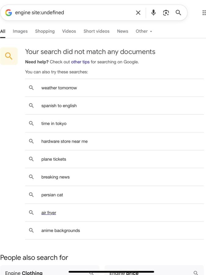

            I tried the cloud version on my vB 6.1.3, but it doesn't seem to work.
              Glenn as you know I’m on cloud too. Installed the mod script and removed all search engines but google. Searched for “engine” which brings up 336 pages on my site. Clicked google and here is what I got
                Mitch, the Google search box shows "site:undefined". It should show your forum base URL instead of undefined. I'll take a look.
                Learning, is your issue the same as Mitch's? If not, please provide more details.

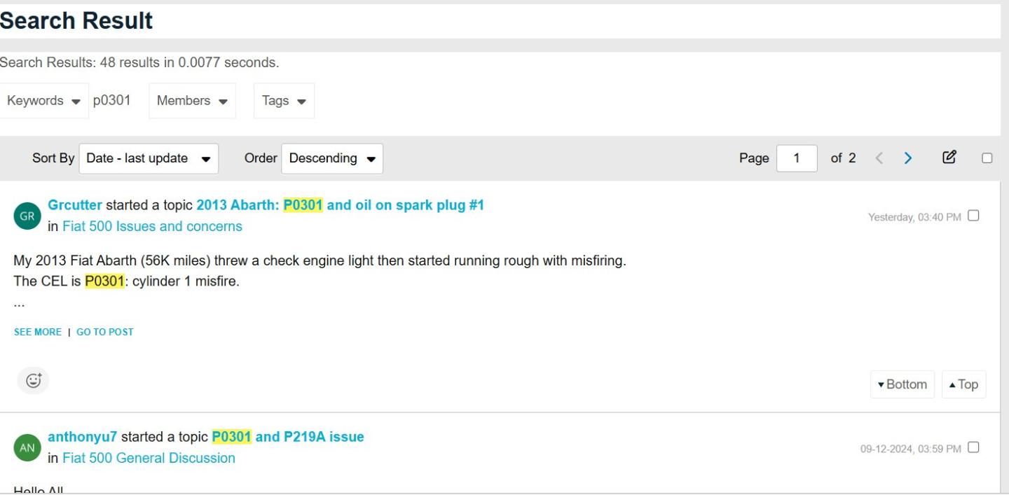

                        Seems pretty straightforward. As far as I can tell, I followed the instructions. I didn't modify the script. Just copied and pasted it.
                        This is what comes up.
