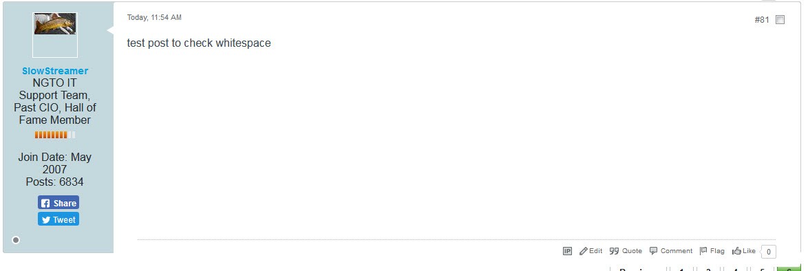

        your above statement helped me understand what was going on. The post content is just matching up with the left Avatar field. In that case, what I see is normal for single line replies. Thank You for clarifying.
Name:	3-25-2019 11-55-08 AM.jpg

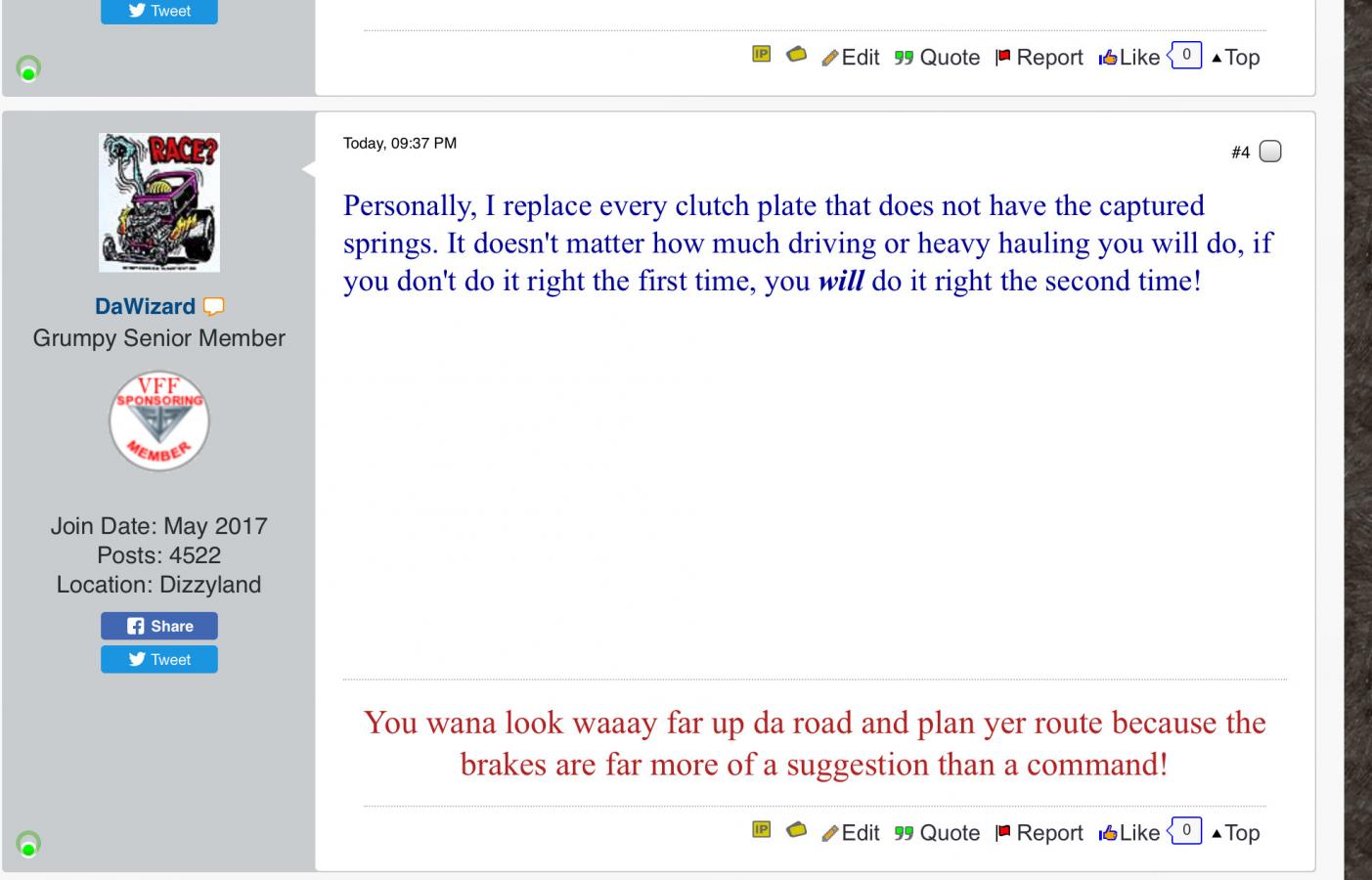

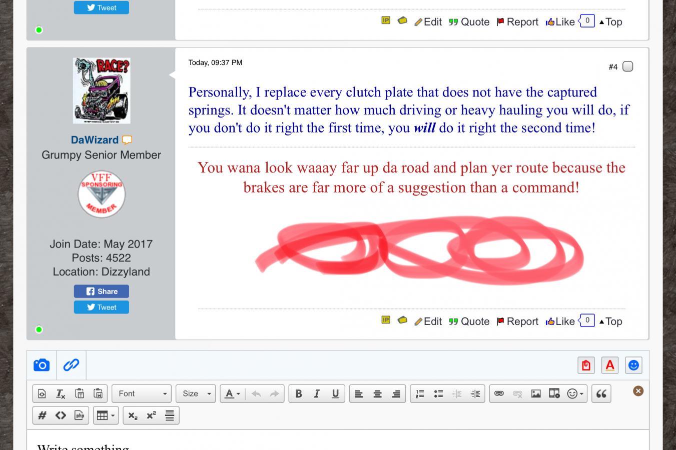

                  It seems since the new 5.5.6 update that on some users, the signature white space is huge underneath it. I removed the above CSS code and it goes back to normal, but of course the whitespace returns in the post area. Until we get some more info of why i'll leave the css off for now. Would rather have the white space in the post than under the signature.
                  Please Help!!
                  With CSS

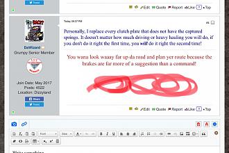

                  Click image for larger version  Name:	1CF32896-C5A6-4D6C-A8FC-325986CED618.jpeg Views:	0 Size:	137.2 KB ID:	21221
                  Without
                  Click image for larger version  Name:	9C8EC8F7-86F7-430A-97AE-940C6C28C694.jpeg Views:	0 Size:	112.4 KB ID:	21220

                  • NumNum
                    I notice this also, but seems to begin after the OP. All subsequent responses are affected.
                    Thanks for confirming.
                  #25
                  I can confirm this.
                  In short posts, signatures now 'float' up to the bottom of the post text, leaving any unavoidable space underneath, whereas previously they would sit at the bottom, with the unavoidable space above.
                  This is not just in replies, it is in all posts where there would be *necessary* whitespace in the post itself.
                  To me a signature always needs to be at the bottom.

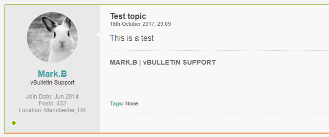

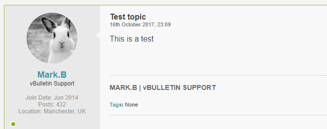

                    #26
                    What we should see:
                    Click image for larger version  Name:	sig1.PNG Views:	0 Size:	25.7 KB ID:	21365
                    What we actually see since 5.5.6:
                    Click image for larger version  Name:	sig2.PNG Views:	0 Size:	25.8 KB ID:	21368

                      Add this code here into your css_additional.css template in Style Manager in AdminCP or in Sitebuilder CSS Editor:
                      .l-desktop .b-post__body {
                          display: flex;
                          flex-direction: column;
                          height: calc(100% - 23px);
                        I added that code and nothing changed.
                      #28
                      Well Mitch, it can't work unless you remove the old code first of course
                        #29
                        Well thanks, yes it works after removing the old code. We’re not all rocket scientists here . Now how do I get rid of those stripes under each posting?TIA
                          #30
                          The above solution was tested on 5.5.6 and 5.6.0 RC2, and it works without adding anything else.
                          Perhaps some other code in your custom style is interfering with that code I have written earlier.
                          Try this, add this to your css_additional.css template or overwrite the existing code I have posted above:
