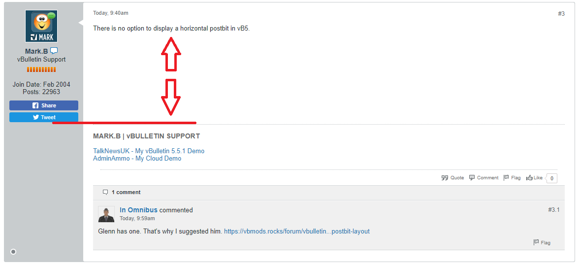

In vBulletin 5 topic page in thread view, there is an excessive and unnecessary whitespace in posts. Please see screenshot for reference:
With the way the HTML is structured in posts, the postbit height is pushing the post body down causing unnecessary whitespace.
To fix this, I've spent a lot of time figuring out a perfect solution that will work on different scenarios (with/without Share buttons, with/without signature, longer postbit, longer post body, more profile fields in postbit, etc.).
I've attempted a fix for this not so long ago but it wasn't perfect and failed in some scenarios. Then I abandoned it. Then when someone posted this issue again on vb.com today, I attempted to fix it again. After tinkering with the code, I think I finally figured out a perfect solution (I hope so).

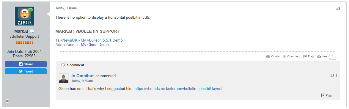

Here's the screenshot with the CSS fix applied:
Here's the CSS code that you need to add in css_additional in Style Manager in AdminCP or in Sitebuilder CSS Editor.
