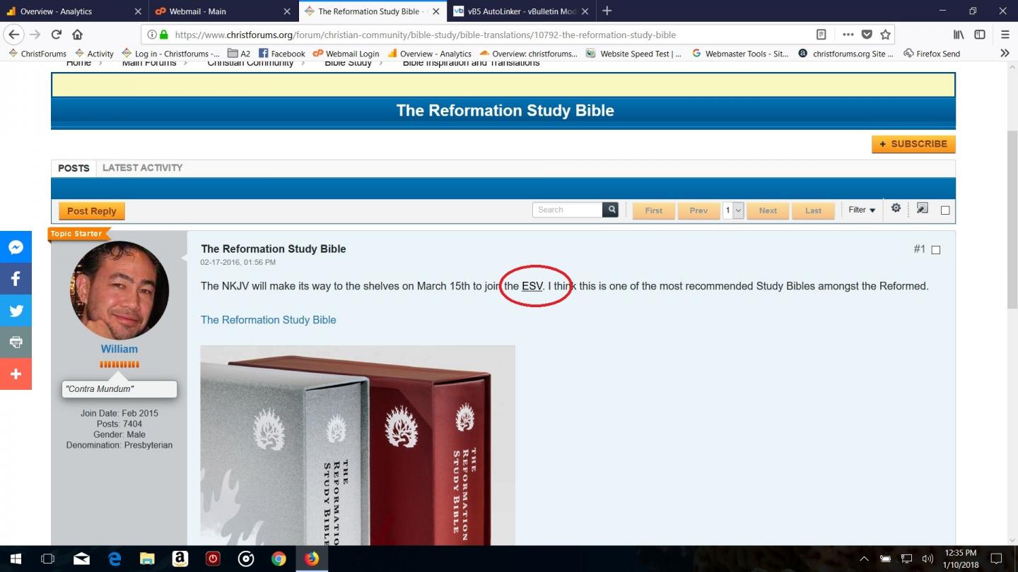

    My greatest problem is trying to make the links look as non intrusive and non distracting while reading the content. I wanted them distinct from regular hyperlinks so I have settled on just underlining the Amazon hyperlinks without a color change:

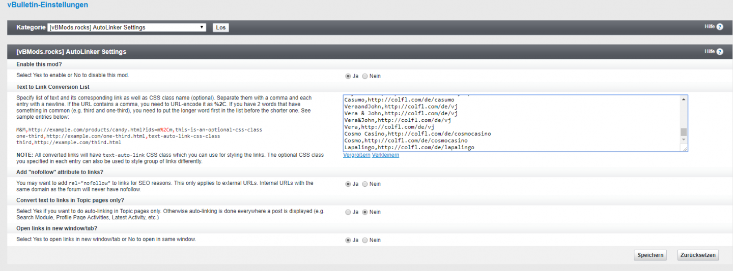

              Glenn, could you please check on something for me ... Here my AutoLinker Settings:
              Click image for larger version  Name:	Capture5.PNG Views:	1 Size:	420.7 KB ID:	10483
              it works for me for most links but for example here look at the last 2 posts in this thread:
              https://kasinoforum.com/forum/online...lege-mehr-habe
              Vera & John or Vera&John or Laplingo should all get linked according to my setting but they are not.
              Update: I copied Lapalingo to the top of my conversion list and now the link shows. However, there is nothing else in my conversion list that should interfere as far as I can tell
                This is the same issue that Fleiding reported in post #38. I haven't found a fix for it yet. For now use "and" instead of "&".
