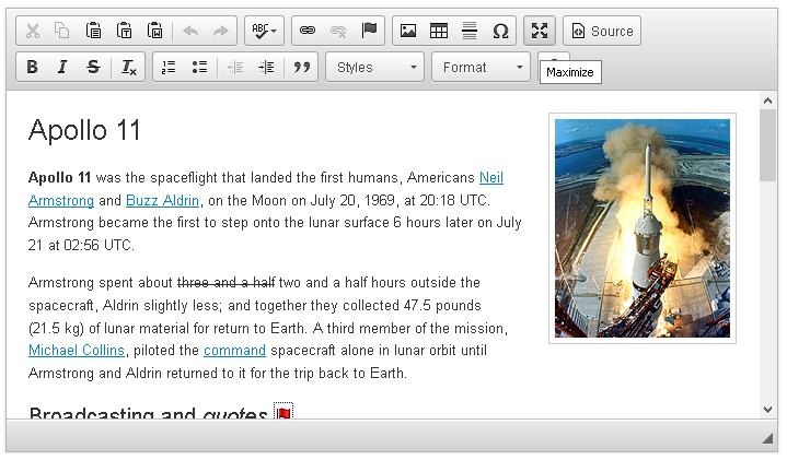

                Somewhat off topic here, I have made a number of such hacks, forgot most, but the one I can't seem to nail down is the maximize function.
                In the default CKEditor it exists, and in older version of vB. But not in 5x that I can tell.
                I upgraded the code to the latest 4.5.11, but I think it is the extra vB .js files which are hiding it, something like the config.removeButtons function.
                I also don't get the special character or spell checker buttons, but these I know are overwritten for browser support functions.

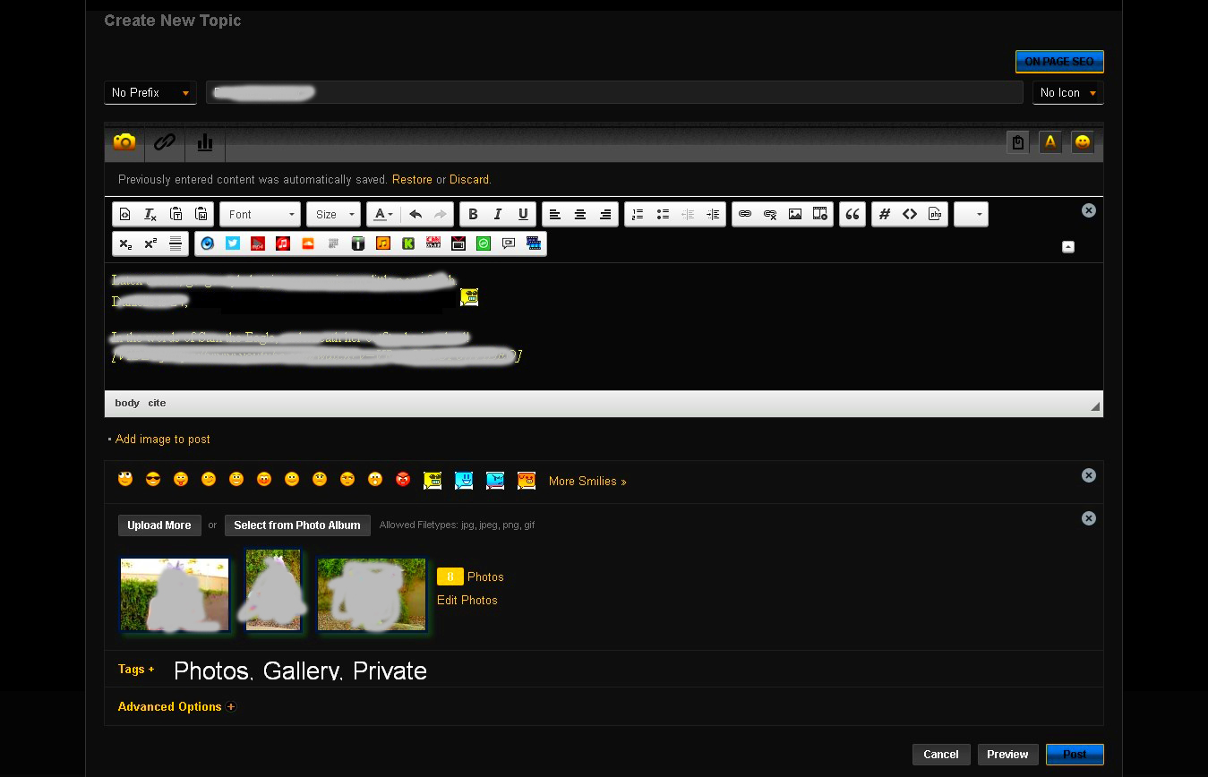

                This is how my edit box appears-
                You can see I have the advanced editor, search engine tools, photo gallery, short URL, Polling, advance Smilies... also, I can collapse the entire tools bar. I can also stretch the edit window vertically. I just can't get it to go full screen and back.
                Any ideas what needs to be edited/hacked to return that function?
