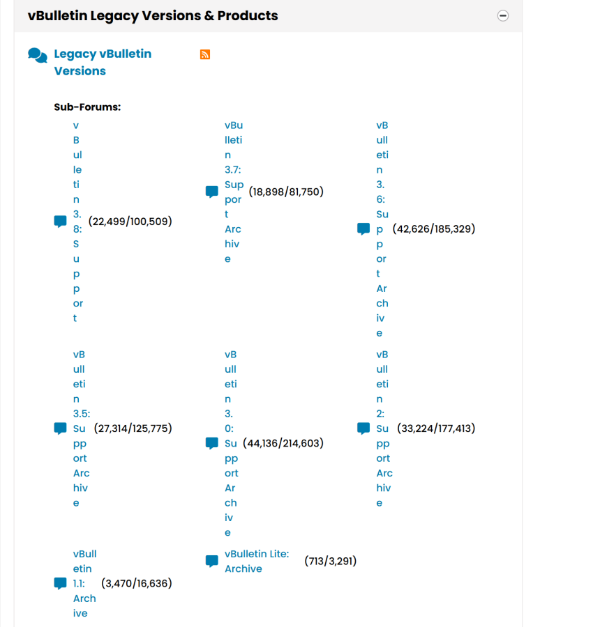

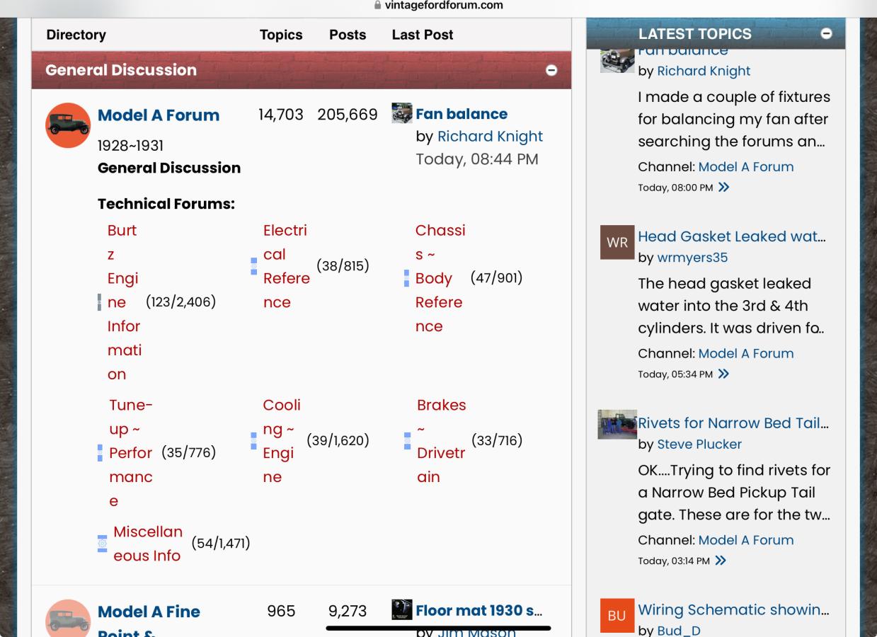

    Next item on my iPad only in landscape mode the sub forum texts are on multiple lines (jumbled).. See screen shot.
    On my PC, IPhone (landscape & portrait), and portrait view on iPad it looks ok.. seems to only be landscape mode on iPad. Thoughts for a fix?​
    Looks like a vB 6.1.1 issue. I checked the official forum:
      I posted the issue in the support forum:
