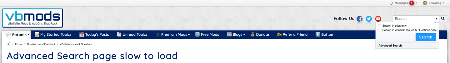

    I just upgraded this forum to 5.7.2 last night and I don't see this issue here. I checked your site and I can see a Search Module below the Advanced Search form. Was that already there before the upgrade?
      And the Search Module shows 623 results. That's why it takes time to load the page because it's performing search on load.

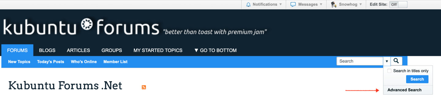

        Yes, as far as I know, that has always been the case. Your site here also has the same.

          Okay, I see what you are referring to. At the bottom of the loaded search page there is an expandable Search. Is that 'module' normal? I didn't add it. Regardless, how does one empty it's contents?
            Someone must have added the Search module at the bottom on your forum. Default vB5 installation doesn't have it. Advanced Search page only contains the search form.
              Enable Sitebuilder on that page, click Edit Page and then remove the Search Module at the bottom
