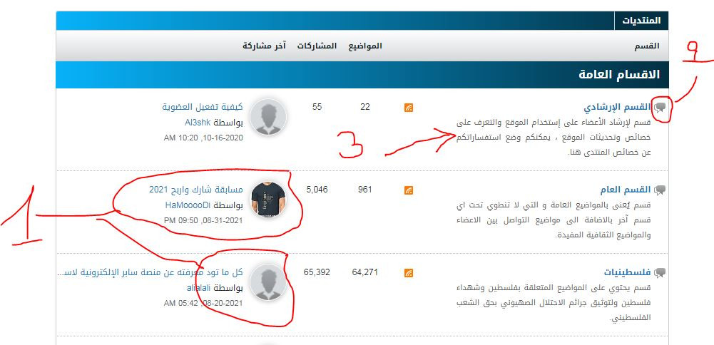

    I would like to remove the author's name and avatar on the side page of the forum interface, as shown in the image.

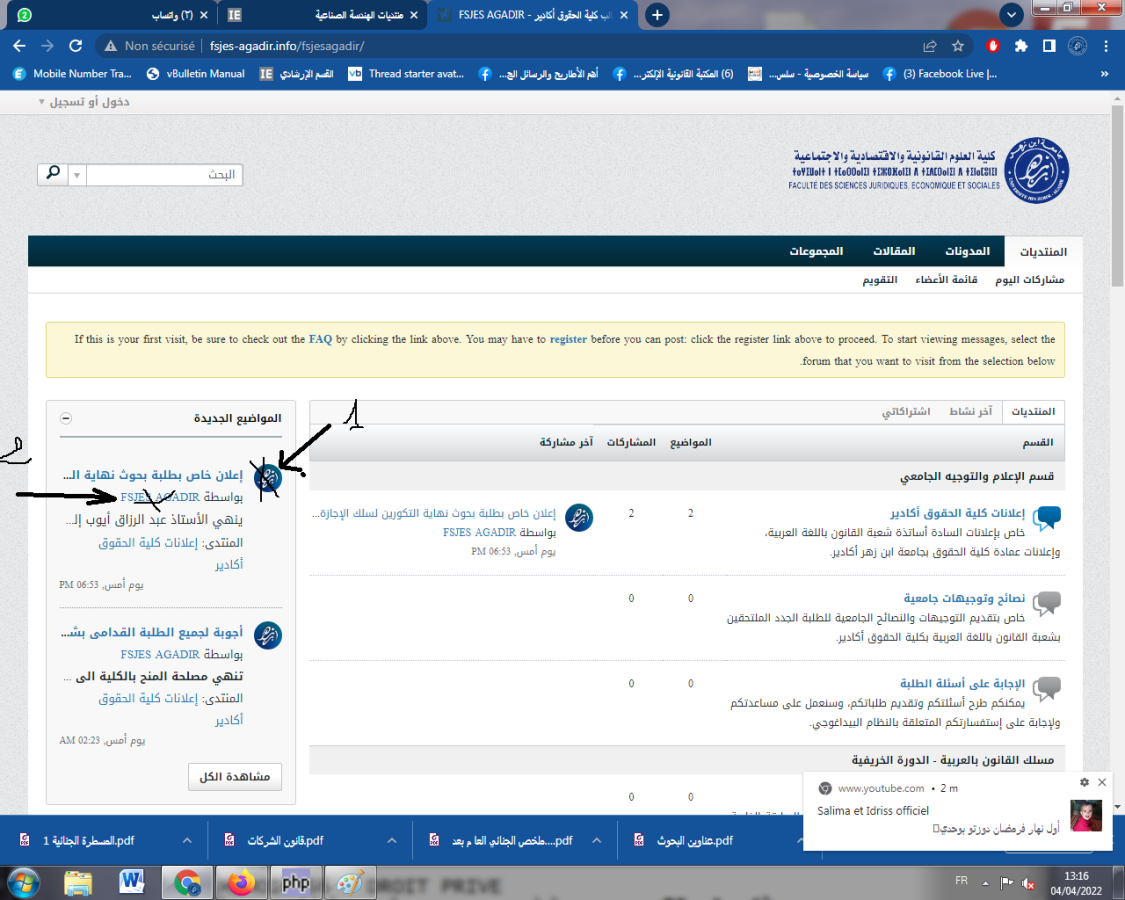

    Amendment No. 01: The size of the icon and its font is large. How can I control its size, especially when I open the website on the phone, the icon appears and the writing is large.
    Amendment No. 02: I would like to know how to control the font size in the place indicated by No. 2.
    Edit No. 03: How do I change the color in place No. 3.
    Amendment No. 04: I want to see the shape of the avatar image in the front of my site and in the members' file as on your site, how is that?

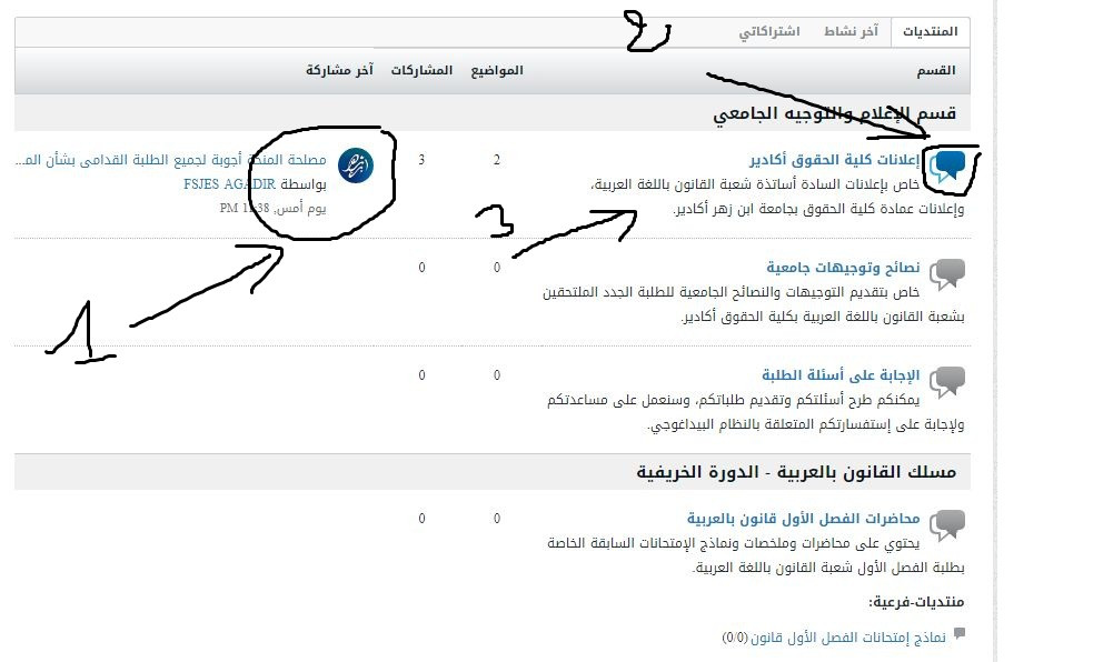

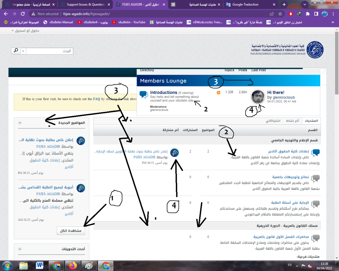

      Concerning Amendment No. 4: What I want is not to convert the avatar into a circular shape, as it is circular as you see it in the image. What I want is for it to appear in the same size as it appears on your site and on other sites I browsed, I mean the avatar in the main on my site is smaller than it is on your site And at other sites.
        As for Amendment No. 02: What I want is to control the size of the description of the sections, so that I want the size of the description font to be just a little less.
        And the code you gave me didn't work for me.
        See the notes in the pictures in the attachments:
        Note No. 01: See the size and shape of the avatar in the two sites, on my sites the avatar appears smaller than the avatar that appears on that site and your site as well.
        Note No. 2: How can I reduce the icon for sections? Can I change it to another icon in another way?
