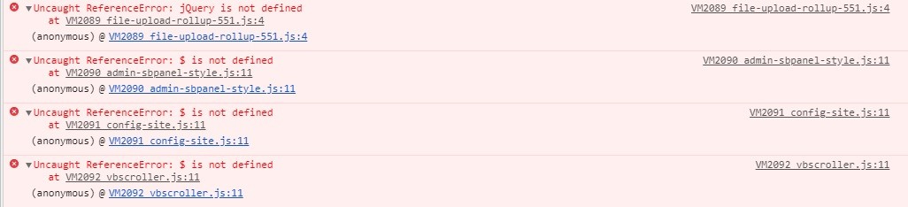

    So I am still learning the language when it comes to identifying the cause of particular issues, but I was checking the Dev console and on my home page I am getting these errors as per the screenshot attachment.
    Any ideas on what these are referring to ? I can see the term ''Style'' reference so is this a style template issue ?

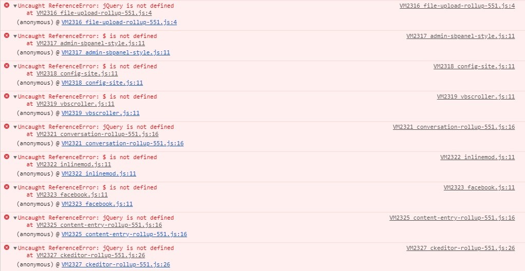

    Furthermore of any typical thread I also get the following errors as per the attached screenshot. Any enlightenment would be highly appreciated.
    Thread page errors

    Home page Errors

    jQuery library failed to load causing errors from other scripts that depend on it. Did you change the jQuery location option in AdminCP?

                  Did you add it for the Bing Ownership Verification? You should never ever add <html>, <head> and <body> tags anywhere as the page already has them. If you want to enable Bing Ownership Verification, you should only add this <meta> tag similar to what you did for Google Ownership Verification:
                  <meta name="msvalidate.01" content="AA47AA258ACB84CA14328881EFFB495F" />
                  And the jQuery error (at least for guests) is caused by including the js/privacy-consent-banner.js?v=551 JS file which requires jQuery and jQuery is not yet available at that point as it is included later at the bottom of the page. That privacy consent JS should never be added manually as it is already being added by the system at the bottom of the page right before the end of the </body> tag.

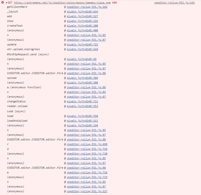

                        I am in the process of re-enabling the products one by one and then testing to see for any issues, I did notice that when when monitoring the Dev console, upon dropping an image into the CKEditor (but not yet submitting) enabled by your drop and drag product, I get the following error, though the image does insert just fine if I submit it and functionality is not affected. Any idea what is doing that ?
Name:	Drag n Drop Error.jpg

                          I checked the previous versions and it looks like starting vB 5.4.3 or 5.4.4, they removed the "images" folder under "moono" folder. That close.png (X icon) is referenced by ckeditor-rollup-551.js but it has been removed. I still have the "moono/images" folder on this site as I never deleted existing files whenever I upgrade. You can copy mine if you want and create "images" folder on your server and upload it there.
                            Thanks, that fixed that one nicely ! Will be sending you a hot coffee shortly
