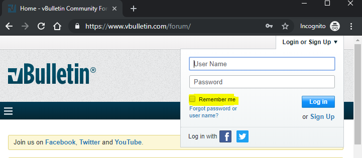

          It is worth noting that with VB.com there is no remember me option when you login
          It does just like any other vB forums.

          I am aware of the login issue on this site. I haven't fully investigated the issue yet.
            Strange, thay honestly was not their when I last looked, checked on mobile and it is surely there, odd.
