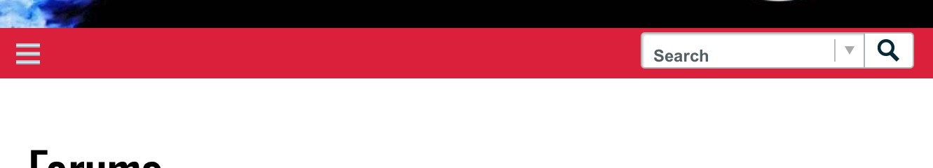

            Since the above posting I noticed that the search text is off only on IPad and I phone landscape view. I posted this over on VB
              I see the same on my self hosted site.
