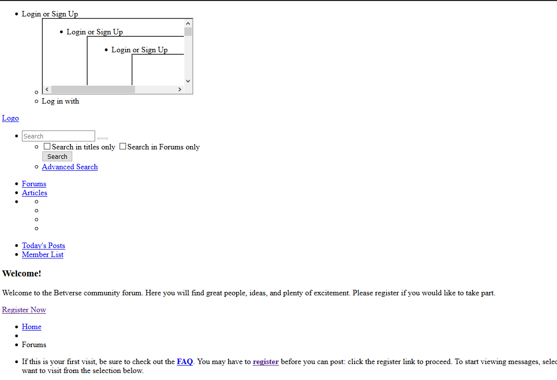

    Hi guys,
    Somewhere along the way of trying to secure my forum from http to https, I broke it.
    Any suggestions on where to look for a potential fix? This is the http version of the site, so no content SHOULD be blocked. Thanks

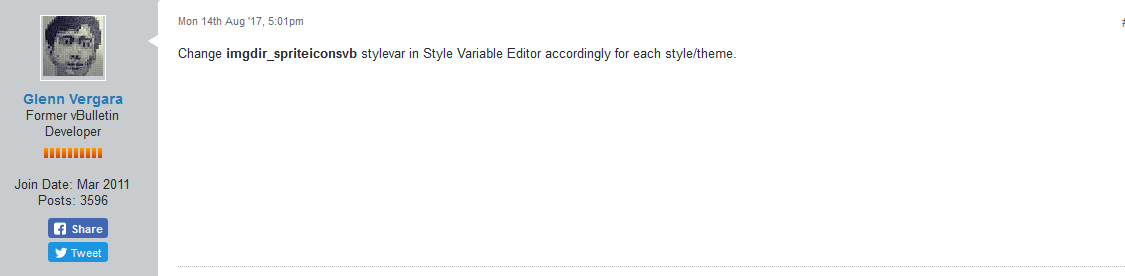

                        Even when glenn isn't around, he's around:
