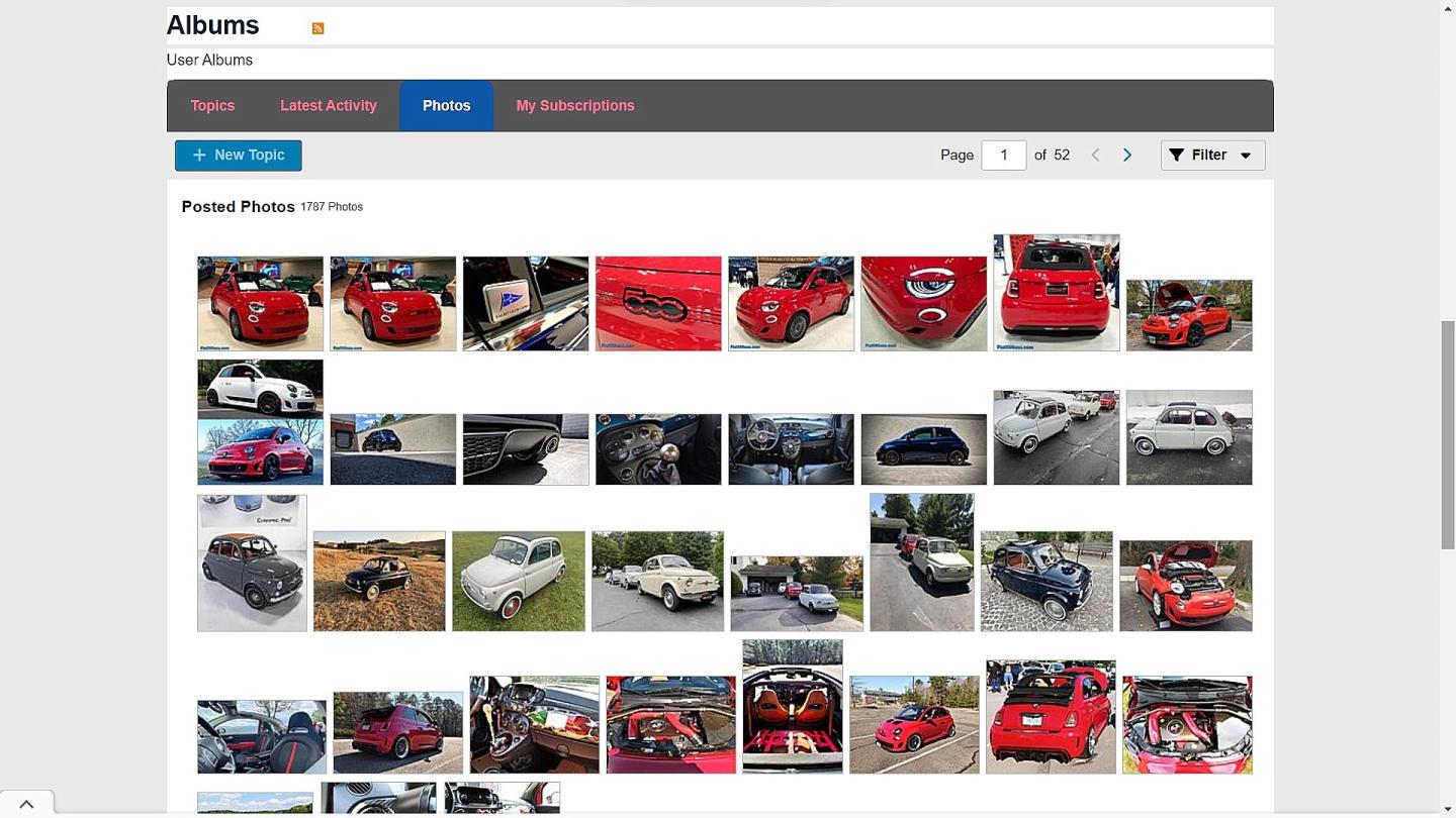

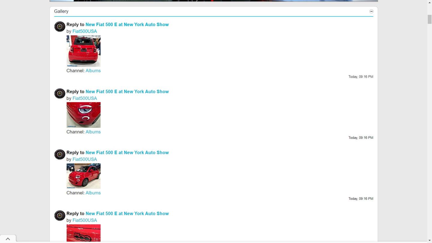

          Below is on my forum now. It is a from a search module. You click on the link and it takes you to a thread and then you have to select 'Photos". Terrible
          Below is what you are talking about and is better, but ideally I would want the images in Albums arrayed in a grid pattern like this. You could click on a album and then an image and even make a comment on the picture. Just like vB4.
          I guess what I'm talking about above is impossible because I am on the Cloud. That"s too bad because I and others would buy that add on in a heart beat.
          However, maybe I can settle for just a Galley page that shows all the images in a grid pattern like below?

          But are those galleries from a specific forum channel? Each forum channel page has Photos tab that you can make the default tab. The Photos tab contains all the image attachments from the posts in that channel.
          Like this I guess:

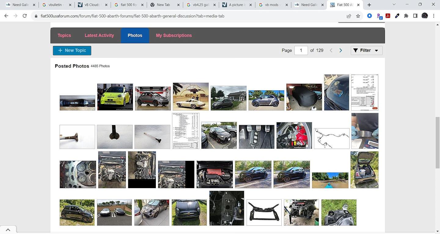

                Basically, you can just link to the Photos tab (even without making it the default tab in the module options).
                Check out the "Sample Gallery" link in the main navbar that I just created as a demo. I linked to it the Photos tab of the vBulletin 5 Template Only Modifications forum channel. Clicking the "Sample Gallery" link will open the Photos tab by default. But clicking that forum from the forum directory listing on homepage will open the default Topics tab.
                Notice the difference in the URL. The Photos tab URL contains ?tab=media-tab in the querystring. That tells the page to open the Photos tab by default. Without that URL querystring parameter, it opens the configured default tab Topics in the module configuration.
                In the same way, if you want to link to the Latest Activity tab, you'll add ?tab=activity-stream-tab parameter. Notice that the URL changes whenever you open a tab. You can copy that URL and add it to the navbar.
                If you want to always open a specific tab by default from both the forum directory listing or from the navbar without specifying the tab parameter in the URL, you can modify the Channel Display Module in Sitebuilder (Edit Site ON) and configure the Default Tab option. You can also re-order the tabs in the Tab Order option if you want. If you want a specific forum channel to have Photos tab by default, then when you click Save Page, choose "Overwrite Template" as No and then specify a different template name.
                  Thanks again! I did it. Easy, too. Not exactly like my old forum, but it is a basically a Gallery with images. The goal is to keep people on the site via the thousands of images to view and maybe they'll engage in a conversation. Still hard to believe vB4 had it and vB6 doesn't have it or an improved version. You've got to have a Gallery if you have an Automotive Forum.
