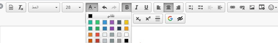

    Can I change the automatic appearing colours? and choose what I want to be automatic shown in box?

                Yes, I am pretty sure, and have confirmed it again now, using version 6.04 and this is the js: ckeditor-rollup-604.js
                These are the colors I want:
                ff3300,FF6500,cc0000,0000aa,0033ff,16A085,3366ff,003366,2c4e80,0066ff,ff33cc,6c0345,000066,C0392B,A0153E,6633cc,27AE60,1E824C,AA8A0A,DDD,008000,000,999,FFF
                And this is what it is

                  When you open the ckeditor js file in the browser using the below link format, do you see the changes you made?
                  <forum-base-url>/js/ckeditor-rollup-604.js
                    Yes, the changes are there

                          When I view a topic on your forum and view the HTML source, it's odd that I don't see the script js/ckeditor-rollup-604.js or any rollup JS files being used. This is what I see at the bottom of a topic page in your forum:
                          <script type="text/javascript" src="js/blueimp/jquery.fileupload.min.js?v=604"></script>
                          <script type="text/javascript" src="js/fileupload.js?v=604"></script>
                          <script type="text/javascript" src="js/admin-sbpanel-style.js?v=604"></script>
                          <script type="text/javascript" src="js/config-site.js?v=604"></script>
                          <script type="text/javascript" src="js/vbscroller.js?v=604"></script>
                          <script type="text/javascript" src="js/jquery/jquery.condense.custom.min.js?v=604"></script>
                          <script type="text/javascript" src="js/notice.js?v=604"></script>
                          <script type="text/javascript" src="js/infraction.js?v=604"></script>
                          <script type="text/javascript" src="js/conversation.js?v=604"></script>
                          <script type="text/javascript" src="js/subscribe.js?v=604"></script>
                          <script type="text/javascript" src="js/tag-editor.js?v=604"></script>
                          <script type="text/javascript" src="js/inlinemod.js?v=604"></script>
                          <script type="text/javascript" src="js/facebook.js?v=604"></script>
                          <script type="text/javascript" src="js/flatpickr/flatpickr.min.js?v=604"></script>
                          <script type="text/javascript" src="js/flatpickr.js?v=604"></script>
                          <script type="text/javascript" src="js/content_entry_box.js?v=604"></script>
                          <script type="text/javascript" src="js/ckeditor/ckeditor.js?v=604"></script>
                          <script type="text/javascript" src="js/ckeplugins/vblink/plugin.js?v=604"></script>
                          <script type="text/javascript" src="js/ckeplugins/vbwrapbuttons/plugin.js?v=604"></script>
                          <script type="text/javascript" src="js/ckeplugins/vbsource/plugin.js?v=604"></script>
                          <script type="text/javascript" src="js/ckeplugins/videotag/plugin.js?v=604"></script>
                          <script type="text/javascript" src="js/ckeplugins/autosave/plugin.js?v=604"></script>
                          <script type="text/javascript" src="js/ckeditor/adapters/jquery.js?v=604"></script>
                          <script type="text/javascript" src="js/ckeditor.js?v=604"></script>
                          This is the expected scripts where all the rollup JS files are used:
                          <script type="text/javascript" src="js/file-upload-rollup-604.js"></script>
                          <script type="text/javascript" src="js/notice-rollup-604.js"></script>
                          <script type="text/javascript" src="js/conversation-rollup-604.js"></script>
                          <script type="text/javascript" src="js/content-entry-rollup-604.js"></script>
                          <script type="text/javascript" src="js/ckeditor-rollup-604.js"></script>
                          Did you make any changes to the footer template?
                            Did you set the no_js_bundles setting in the root config file to true like this?
                            PHP Code:
                            // This setting should never be used on a live site
                            $config['no_js_bundles'] = true;
                            It's recommended to set it to false which is the default setting. Setting it to false bundles multiple JS files into 1 rollup file. The less files to include on a page, the better for performance.
                              But if you want to keep it not using JS bundles/rollups, then the JS file you need to edit is the /js/ckeditor/ckeditor.js and not /js/ckeditor-rollup-604.js.
