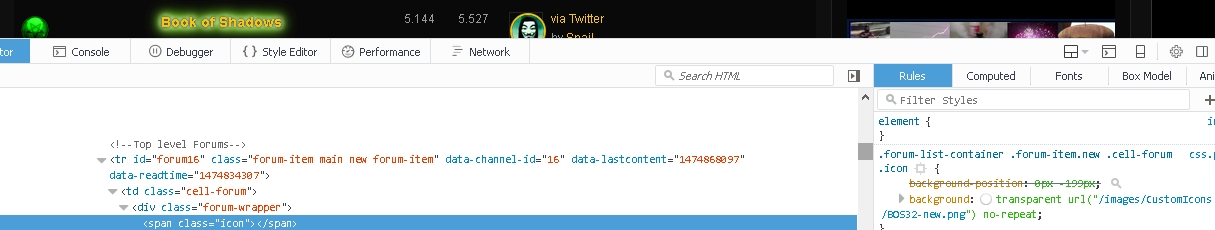

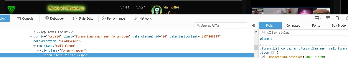

    What is troubling me is that I can enter the code into the browser manually and it works as expected, however, if placed into css_addition or css_global, it breaks.
    On page load, with code in css_additional, the changes don't appear and the default theme icon is present- Click image for larger version

    If I manually enter the code, it works. Click image for larger version

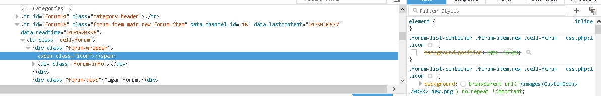

                          Using
                          #forum16 .forum-list-container .forum-item.new .cell-forum .icon {
                              background: transparent url("/images/CustomIcons/BOS32-new.png") no-repeat;
                          I am able to target the forum, but the icon is buried under the default one.
                          And according to what I read, by adding !important to bring this code to the front, disables the use of ID.
                          Target forum, or, show icon, but thus far not both.
