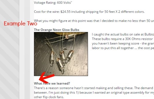

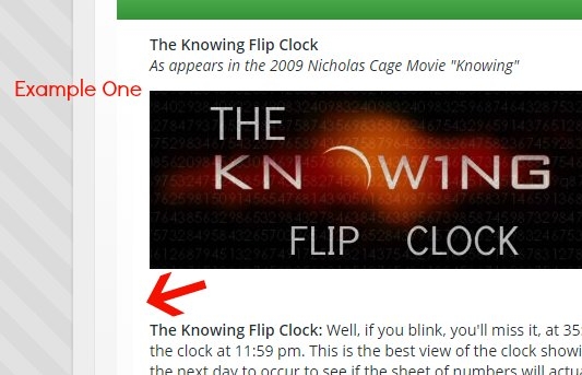

        Thanks. Where exactly do you want to add padding/margins? Could you take a screenshot and mark it?
          Click image for larger version  Name:	example1.jpg Views:	1 Size:	103.5 KB ID:	3982
          Click image for larger version  Name:	example2.jpg Views:	1 Size:	93.0 KB ID:	3983
          In the first example: this is after I have added a div to increase the padding. It's changed the default font size for some reason. I don't mind it, but I cannot figure why containing the contents of this article in a div would change the font. In example two: this is from a different, unaltered article ... lower on the page. The way the theme was designed, the text ends up right on the edge of the white background as you scroll down. I just don't like that look.

            It changed the font size from 12px to 14px because you have a span container with inline font-size style.
            <span style="font-size:14px;">
                <div class="default-article-spacer">
                </div>
            </span>
