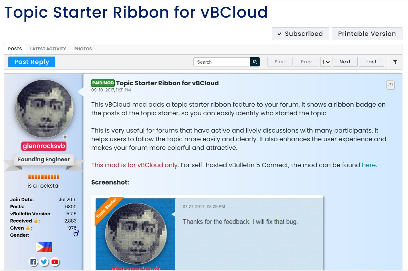

          I noticed it is doing it on this site, too, when I came from the email notification link the website sent. I can change pages and it still doesn't show, but when I refresh the page, the ribbon shows up.
            It happens to me on this site too. For some reason it does not happen on my site. Weird
            The Topic Starter Ribbon mod installed here is for self-hosted version which has different implementation than the vBCloud version. I'll check what's wrong with the self-hosted version.
          I think there's a timing issue going on. That's why it's inconsistent. I'll fix it and release a new version.
