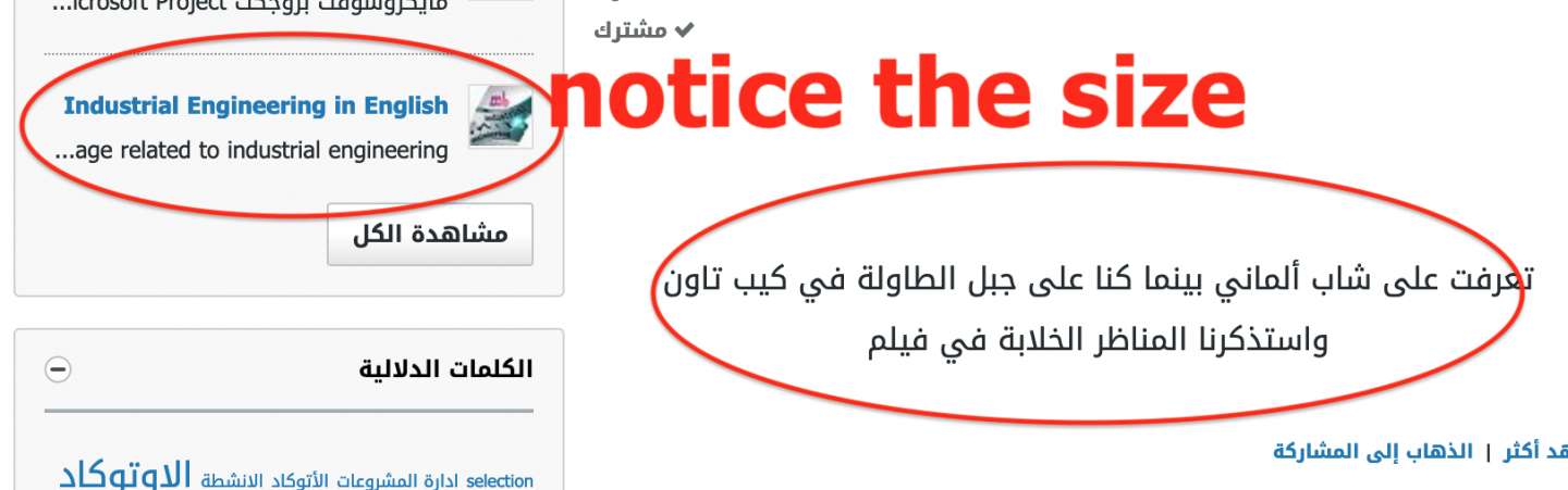

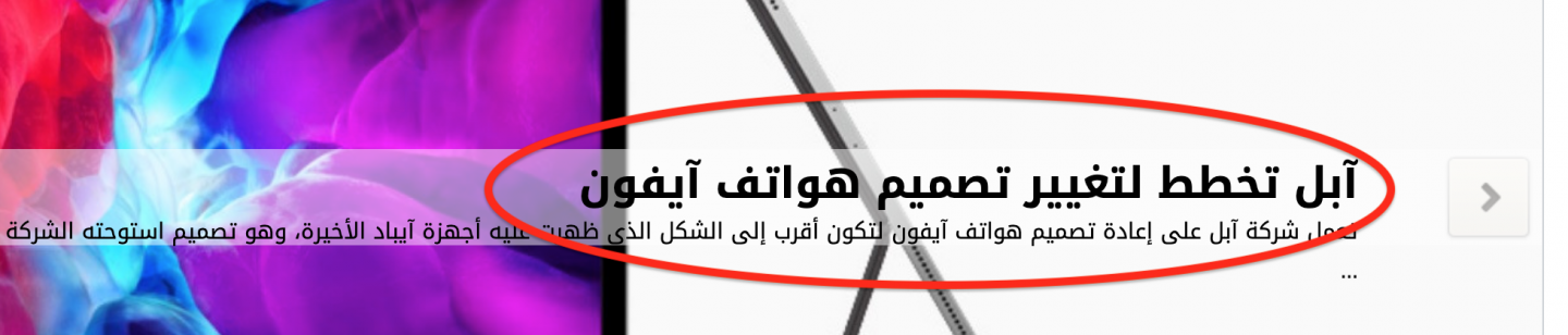

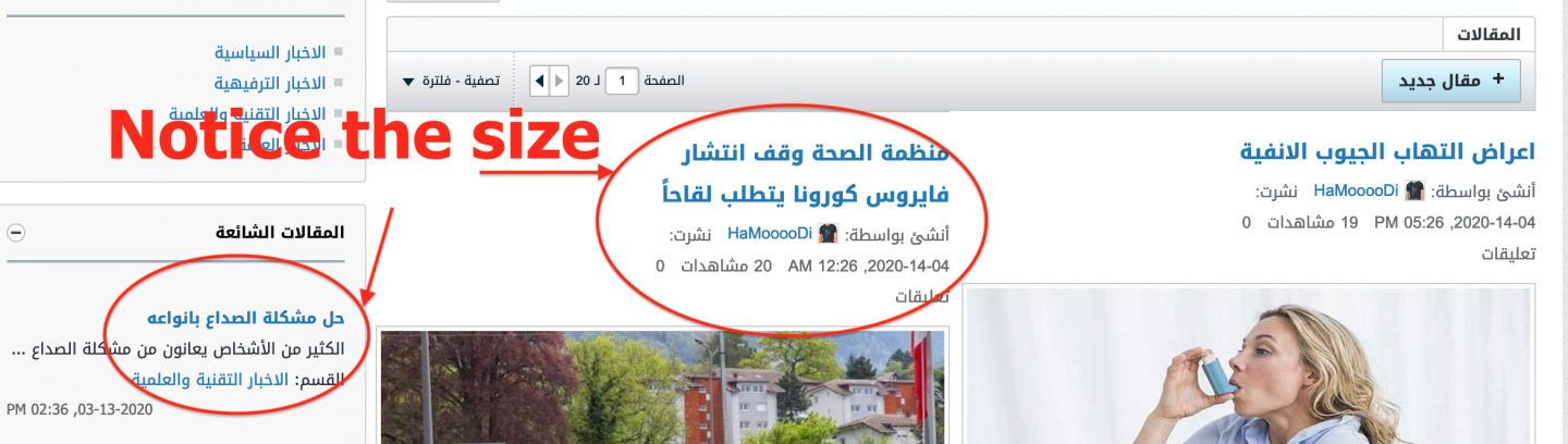

    however I have an Issue with other areas "article channel display module" and "content slider module" and "Blog home module" , I do have customized font, its working everywhere with the font size I already put in the stylevar inside the adminCP exept in the above areas, please see below screenshots
    appreciate if you could customize the above CSS to to work in these three areas
