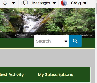

                            The behavior with vb 6.0 makes it look a bit clunky, specifically in responsive mode It is find in desktop mode. Is there a way to have it only show at higher responsive mode, then revert to the menu mode for tablets and phones?
Name:	Screenshot 2025-02-11 175738.png
