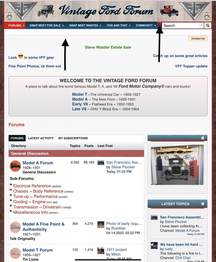

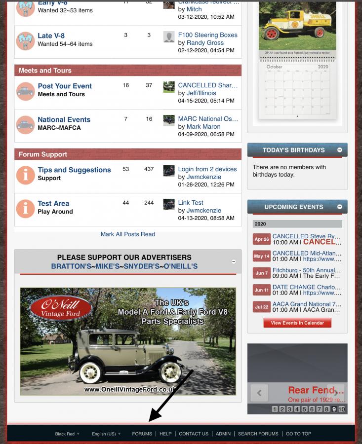

                  That fixed the logo / header border issue that I had. See these screenshots and the black arrows. Is there a way to get rid of the red in those areas? This happens with any code I use

                    #26
                    Any Ideas out there?
                      #27
                      Glenn
                      I have this all installed but the header. The code above does not work on my site. Any suggestions for a header code.
                      Thanks
                        #28
                        Mitch It actually works on your forum. It's just that you have a dark body background that the drop shadow cannot be seen. If you removed the background, you would see the drop shadow.

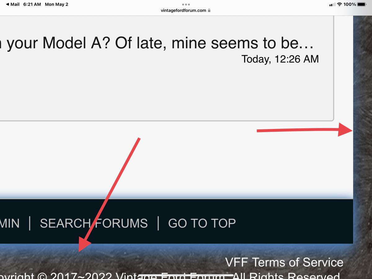

                          #29
                          I changed the dark shadow to a blue hue, everywhere but the header. When I use the header code it is not at the edges, but places the blue shadow inwards. It also effects the color of the menu drop down bar
                          Here is what I have so far
                          .l-desktop #channel-tabbar,
                          .l-desktop #footer {
                          box-shadow: 0 0 8px rgba(63, 127, 191),0 8px 16px rgba(63, 127, 191)
                          .l-desktop #content {
                          box-shadow: 0 12px 8px rgba(0,0,0,.18),0 15px 16px rgba(63, 127, 191);
                          .l-desktop #notices {
                          box-shadow: 0 5px 8px rgba(0,0,0,.18),0 10px 16px rgba(63, 127, 191);
                          .l-desktop #breadcrumbs,
                          .l-desktop #channel-subtabbar {
                          box-shadow: 0 3px 8px rgba(0,0,0,.18), 0 14px 16px rgba(63, 127, 191);
                            I will check again.
                          #30
                          Mitch, remove all the existing box-shadow code and replace all with this CSS code:
                          #wrapper {
                              filter: drop-shadow(0px 7px 7px rgba(3, 127, 191, 0.95));
                          vB5 HTML structure has changed since this mod was created 4+ years ago and the drop shadow code for the content that includes the header seems to be able to be simplified to the above code.
