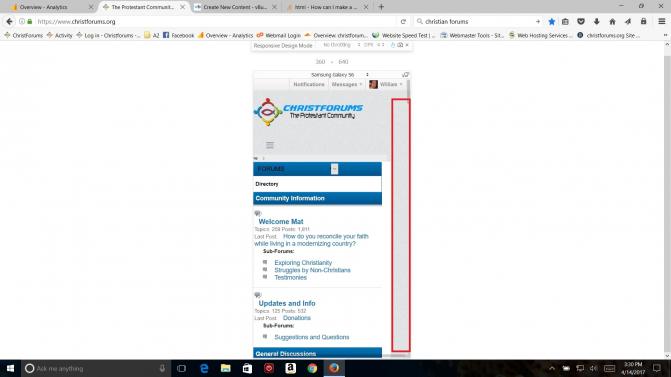

    Is there a trick for finding the cause of a template's horizontal scroll bar on mobile devices?
    For example in 360 x 640 resolution:
    Click image for larger version  Name:	overflow.jpg Views:	1 Size:	22.7 KB ID:	3943
    Any help would be appreciated!

    That is a tricky issue to find. You literally have to navigate through the HTML DOM tree in the element inspector tool to find which element is causing it.
      I think I found it. You have this in css_additional:
      #channel-tabbar {
          background: none!important;
          margin-left: 55px;
      I think you only wanted that left margin (and that background:none) on desktop but not on mobile. If so, then:
      [COLOR=#FF0000].l-desktop [/COLOR]#channel-tabbar {
          margin-left: 55px;
        I found two css additions that were causing the overflow. I ended up blanking out my additional_css and just adding parts of the custom code back until I narrowed down where the overflow was coming from. I guess you could say I used a process of elimination
        For example, when I added lines 1-250 back the overflow was there. It didn't take many seconds before I saw the first line causing the overflow.
        I didn't know if there was an easier way to find these issues in the future.
