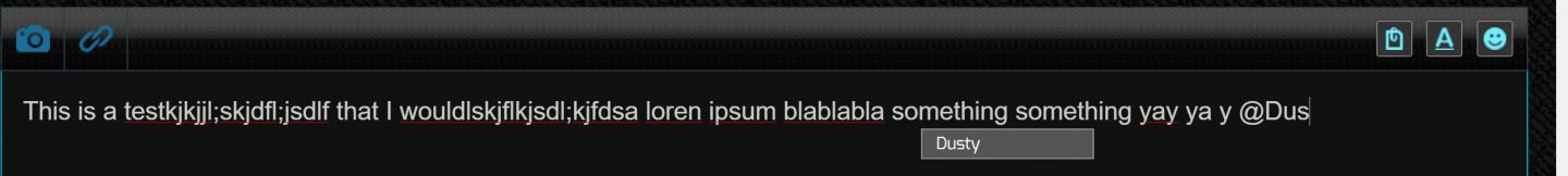

        So along the lines of changing the color and the font size in the editor, there seems to have been an unintended side-effect. I have the CKEditor font set to 18px thanks to your help. When an autosuggestion comes up in the editor from an @mention its position will be off by quite a bit. If the mention is towards the middle or right of a line the mention comes up far to the left.
        Is there a way to correct for the 5px text size increase in CSS or do I need to look in the JS for something?

          I have to see how it looks like in order for me to suggest a solution.
            Yeah, that might help. Sorry, it's late.

              Is that issue caused by increasing the editor font size? I haven't seen that issue here.
                Yes, it seems to be. If I remove the font-size statement in the rollup js it aligns properly.
                  Spent a bit of time on this today but made no headway. I can see by inspecting the suggestion popup that it's got a left value being inserted inline. What does this however, is beyond my ability at this point.
                    If you give me a test account to your forum then I could log in and see the issue and possibly provide a solution.
