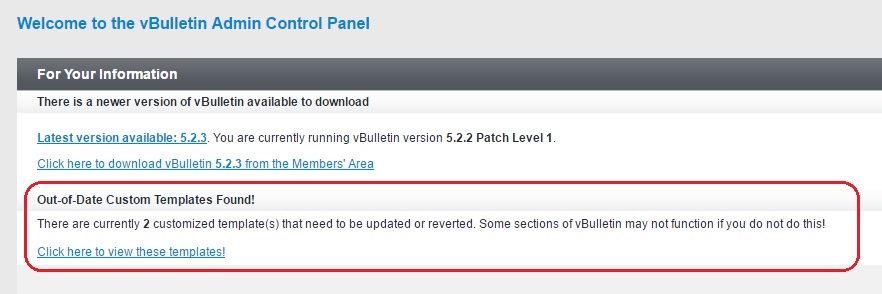

        Yes you have a custom theme but still you are using existing vBulletin templates. Templates are different than themes. When vBulletin releases a new version that contains changes to templates that you also modified, then there might be merge conflicts and if that happens, the upgrade process will not merge the changes and you have to manually merge them and you will see below message in AdminCP

                    If CSS is wrapped in <vb:if> and CSS would not exist, then it means the user is logged in and there's nothing to hide/blur. That's good. But if user is a guest, then CSS would exist and that can still be altered by the user. There is no security in this solution and it is essentially the same as the pure CSS solution except that it modified a number of existing vB templates to add the if/then condition and would be in danger of having template merge conflicts in future upgrades.
